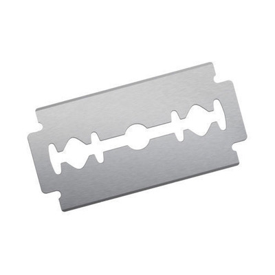

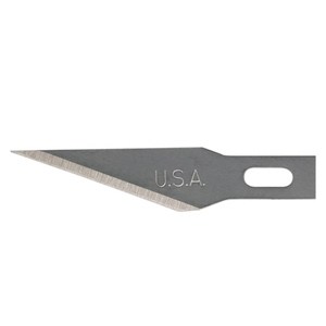

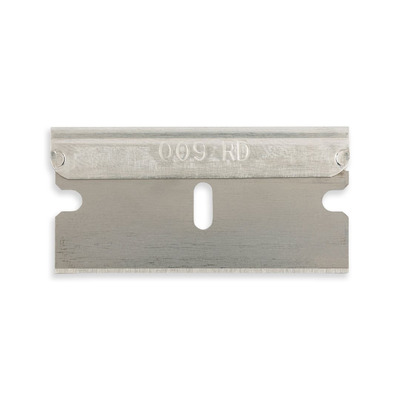

Reply 32927 of 53165, by SodaSuccubus
bjwil1991 wrote on 2020-03-10, 17:36:
You can use a small, flat tipped (bladed) screwdriver and press the legs to the left (rear of the chip) and to the left (front of the chip) in question. Please be careful with this and the sewing needle method should work as well.
I can't for the life of me figure out how I'm suppose to do separate the legs on these 3DFX chips. I don't have any good exacto-knives on hand so I'm still using a sewing needle.
Do I push it in-between the two legs, or move them from the feet?
Man, I'm surprised there isn't some guide for this out there 😕
Anyone mind giving me some clues?

As may have already suggested, try to use a razor blade, or a hobby blade, such as these ones:
59.18 KiB
1366 views
4.33 KiB
1366 views
14.09 KiB
1366 views
Do not push the pins, the best way to clear the short is to slide the razor between them, and gently force the pin to the opposite side of the bend, just fraction of a millimetre.

Reply 32929 of 53165, by SodaSuccubus
YYYYYESSSSS!
I managed to get some help from a steady-handed relative and we managed to separate out the shorted legs just enough.
Card seems to work fine now, just waiting for the SLI bridge 😁

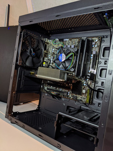

Reply 32936 of 53165, by aha2940
I just got a TMC AI5TT motherboard with the intel 430TX chipset, along with a pentium MMX 233 and 64mB RAM. All for about $27 shipped. I think the price was fair. Pic here:
However, when I received it, I noticed this strange thing over the CPU (see previous pic). It seems to be the heatsink, but I have no idea if it works better than a regular one or if it came originally with the board (it seems so, since it has holes for the capacitors on both sides) or what. It's a thin sheet of metal with the fan on one side. Anybody knows anything about it? I'm leaving some more pics here:
Thanks!
Reply 32937 of 53165, by bjwil1991
I've never seen a heatsink like that for desktop computers, rather for laptops at the most. That is one interesting heatsink, though. My guess is the design allows better air flow in case something obstructs it or if a long ISA or PCI card needs to be installed, like a VooDoo2 card, SCSI card, or sound card, and so on, but I digress.
Reply 32938 of 53165, by aha2940
bjwil1991 wrote on 2020-03-11, 04:55:
Good guess, in fact it seems to be made to allow using full-size PCI cards, however since I'm not gonna use any with this motherboard, I ordered a regulat heatsink with fan on top, because I trust them more (used them since many years ago) and also because when I tested the board, I noticed the part of the heatsink over the CPU was very hot, whereas the part over the fan was not. Also, the fan is so thin (it's a 40x40x6mm one) and you can barely feel it moves the air. That seems to suggest the heatsink is not that good at dissipating heat, so I'd rather not risk the CPU.
