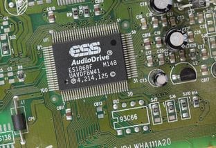

Reply 33660 of 52824, by Bancho
appiah4 wrote on 2020-04-30, 09:17:
Looks like an ES1688/1868 IC.. Awesome card.
I think you might be on the right lines. Looking at the pin markings around the chip look similar to the ess chips
    25.06 KiB
    1523 views

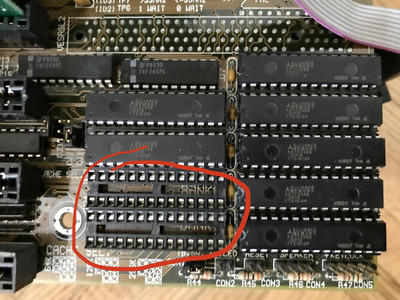

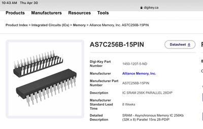

Cache for 486, just grabbed it from Digikey
What modules (specs) did you get?
The wrong ones... 🙁
I ordered them from Digikey, I did as much research before ordering but when I put them in the board this morning, I get a message saying “Bad Cache, do not enable Cache”... this was 32kx8 x8 + 1 extra for Tag. 256kb total. So the specs are the following...
145.57 KiB
1514 views

dave343 wrote on 2020-04-30, 14:43:
The wrong ones... :( […]
mpe wrote on 2020-04-30, 13:08:
dave343 wrote on 2020-04-30, 12:58:
The wrong ones... 🙁
If this is the correct configuration, I would try with half of that. You should be able to configure to 128k with the same chips. That way you can at least most likely rule out that you received a faulty chip.

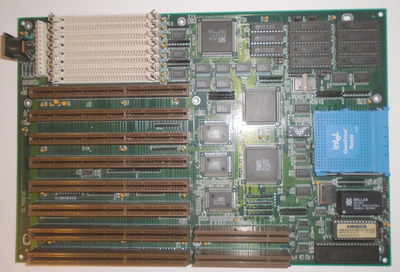

Got two Socket 5 motherboards to satisfy my long term interest in early Pentium chipsets.
1st the Gigabyte with UMC8891 chipset. I am really excited about that one as I was looking for one for some time. This is to debunk/confirm the myth that it is a scaled 486 design.
1.07 MiB
1415 views

Reply 33669 of 52824, by dionb
mpe wrote on 2020-04-30, 18:44:
If it's not, it's the worst memory controller design seen on So5. Using a P100 and RamSpeed, I measured max INTmem score of 38.41 on a Biostar MB-8500UUR and even worse, 30.1 on a Chicony CH-890A. By comparison the next lowest score I did on a 'vanilla' board was 45.6 on an Intel Premiere/PCI II 'Plato' with i430NX. The only thing that came close to the UMC8891 was 39.87 on a PC Chips M571 with SiS 5598 and EDO using integrated VGA. With a discrete VGA card that leapt to 72.59.
Reply 33670 of 52824, by mpe
dionb wrote on 2020-04-30, 19:35:
Not sure about your boards. But this thing is definitely not a recycled 486. Much faster than 430NX on Plato. Faster than SiS501, 430LX and Opti Viper. Just lagging behind Triton.
Clearly 64bit design and 6-2-2-2 mem timing, posted writes, ...
I am happy to find this as I used a UMC pentium board back in 1995-96 and don't remember it to be that bad...
7.58 KiB
1362 views
Still need to tune this and also try with async cache to see the full picture.
The wrong ones... 🙁
I don't think these are wrong ones. Of course there could be bad chips, but that's unlikely IMHO.

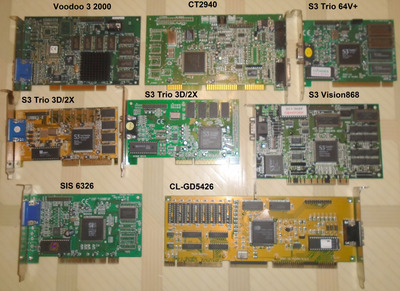

First EISA board since the early 90s - an ECS SL-486VE
1.68 MiB
1328 views
Small lot of VGA cards + 1 sound card from the same seller. Worryingly, there was supposed to be separately boxed Compaq QVision 1280/E which seems to have gone walkabout in the courier system!
1.46 MiB
1328 views

CoffeeOne wrote on 2020-04-30, 20:56:
The wrong ones... 🙁
I’m only getting the “Bad Cache” error when I populate the last 2 banks, Bank 0+1 as in the picture. I tried multiple different cache chips in both those banks but get the same error.
I started by removing all the cache and adding it one by one until I received the Bad Cache error which was with those 2 last banks. I then tried different chips, same error. Maybe bad banks?
Reply 33674 of 52824, by mpe
You should be able to configure it in single-bank config at 128k. A bank is the set of 4 chips (if this is a 486).
Also if you have multimeter it should be easy to troubleshoot sockets. The wiring is actually not that complicated. In general address and control pins are shared by all chips in a bank. Data pins (those on right side of socket) are shared across the bank. Power/GND pins are shared by all chips..

dave343 wrote on 2020-04-30, 23:12:
The wrong ones... 🙁
Start like this, easier for me to type socket filled pattern: Unsocketed not plugged in, "IC" and "tag" means socketed cache chips.
tag, IC, unsocketed, IC, unsocketed.
or:
tag , unsocketed, IC, unsocketed, IC
Or:
tag, unsocketed, unsocketed, IC, IC
or:
tag, IC, IC, unsocketed, unsocketed
IC, IC, unsocketed, unsocketed.
See if you can try this combinations. This is 128K for now.
Cheers,
Great Northern aka Canada.

pentiumspeed wrote on 2020-05-01, 01:37:
Start like this, easier for me to type socket filled pattern: Unsocketed not plugged in, "IC" and "tag" means socketed cache c […]
or:
Or:
or:
Cheers,
Hey thanks for the reply. So the issue with 128k, is that all information I’m getting says 128k I have to use 32kx8 chips, which is fine, but the TAG should be 8kx8... which I don’t have. Unless I can just use a 32kx8 for TAG.
Reply 33679 of 52824, by cyclone3d
dave343 wrote on 2020-05-01, 03:22:
Using a larger capacity chip for the tag should work just fine.
