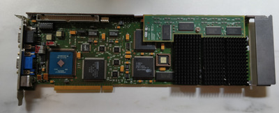

Picked up an Intergraph Intense 3D, a pretty early OpenGL workstation card. It gets a whopping 1 frame every 10 seconds in Quake 3 (with all the settings maxed out).

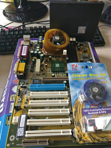

Chaintech 6VJD, my first VIA DDR PIII mainboard. I think I have now the whole collection of PIII chipsets. This boy will be added to the Tualatin chipset competition Pt II.
An QU37ES Xeon PIII 700/1M on 2,8V.
4 Golden Orb knockoffs (one pictured), but they look too similar to have been made outside the same factory.
2 Thermaltake Blue Orbs NB coolers (one pictured).
all NOS, apart from the Xeon.

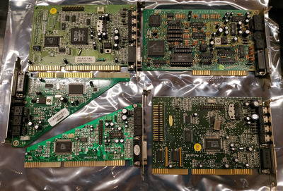

these were part of the big lot recently from 3 different auctions... even though these were sold as scrap, I kindly asked the seller to pack them well and they were, all in pretty good condition too.
a few sound cards, and I think the first CT1350B with CT1366 and not CT1366A that I got.

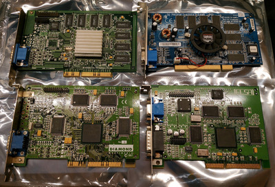

Alliance ProMotion-AT3D card, this seems to be a somewhat odd card with totally broken 3D, but 100Mhz RAM
see: https://www.youtube.com/watch?list=PLOeoPVvEK … a&v=GM8nZKojHds

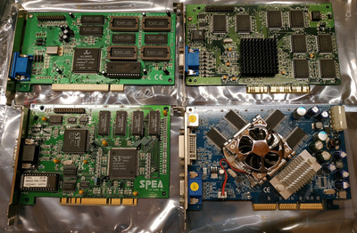

Creative 3D Blaster Banshee CT6750, Voodoo Banshee with 16MB SGRAM :3
the recently mentioned SPEA Mirage P64V Turbo, S3 Vision868 with faster RAM
and a Geforce 6600

more S3 Cards... I didn't know AdLib made graphics cards? "AdLib Genesis 765" Trio64V+
Diamond Stealth SE, Trio32
miro Crystal 20SD, Vision864
ELSA Winner 2000AVI-4, Vision968 with 4MB

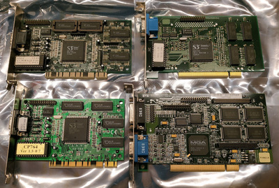

and more S3 cards... SPEA V7-Mirage P64 Trio64, miro Video22SD Trio64V+
a generic S3 Trio64 and another Matrox Mystique 220

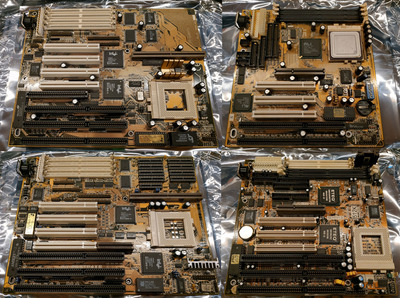

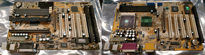

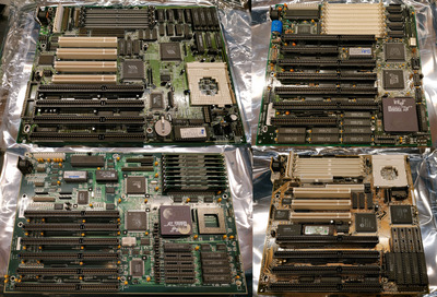

boards boards boards!

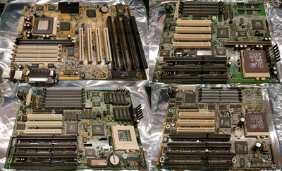

...part 2 of the big "scrap" lot
ASUS TXP4-X socket 7 ATX, FIC PA-2002 socket 7
FIC PA-2000 socket 5, Intel Tahiti socket 5
1.29 MiB
477 views
Gigabyte GA-586ATV socket 7, Gigabyte GA-5AA SS7 with a bit of dirt
ASUS P/I-P55TP4XE socket 7, Soyo SY-5EH5 socket 7
1.52 MiB
477 views
MSI MS6117 440LX Slot 1, Commate? K7TA KT133 Socket A with ISA
538.26 KiB
477 views
FIC 486-PIO2 VIA 496/505 socket 3, unknown 486 ISA board ever so slight surface corrosion on the KB connector, going to get the snip ASAP
Peacock? PCK 486 DX, Biostar MB-8433UUD-A socket 3
1.38 MiB
477 views
BC3486UL, supposedly Opti Local Bus... slight corrosion on the battery, board is clean, snip snip
Chaintech 486SPM socket 3, same as above slight corrosion on the battery, board still clean
and the two more problematic ones...
Hyundai branded Gigabyte GA-486VS, heavily corroded 😒
and an unkown "MB456"? heavy corrosion on the battery and some on the ISA, board looks mostly OK but traces in the battery area might need some repair.
1.59 MiB
477 views

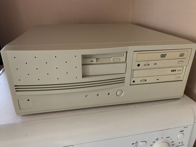

This week I purchased an entire PC which turned out to have a broken motherboard. Dissapointing but I did get a case that will be very useful to me(with psu, 2xhdd and 2xcd) as well as a soundcard, videocard and not pictured 2x 32MB 72pin ram sticks.
