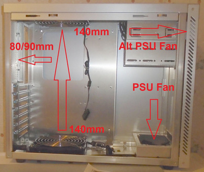

Reply 35261 of 40040, by yawetaG
Warlord wrote on 2020-07-30, 04:18:

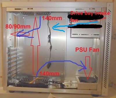

the air flow design on that case tho makes little since.
Why not? The bottom is likely perforated, and as you can see on the pictures there's room below most of the bottom plate. Hot air naturally rises, and gets expelled from the top.
Of course the design is also a great vacuum cleaner (unless it has good filtering in place).
Reply 35262 of 40040, by PC Hoarder Patrol
yawetaG wrote on 2020-07-30, 05:25:

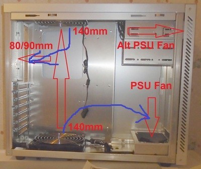

It's fine for a small build; the one issue being the front-mounted PSU fan trying to push warm air out front/bottom thru the one large unfiltered opening (unless you choose to flip the fan around in the PSU). I'm thinking I might top-mount the psu (sfx or tfx maybe) in the 5.25 bay, which I don't plan on using, and adding a vented Lian Li bay cover so that'll allow warm air to be pushed out front/top (better) and also allows me to mount front intake fans in the unused PSU mount area. Apart from that, I'd expect decent airflow from the two supplied 140mm fans (both filtered), plus I can add a rear 80/90mm exhaust as well (the board I'm thinking of has plently of fan headers).
257.97 KiB
709 views
Reply 35263 of 40040, by Shagittarius
PC Hoarder Patrol wrote on 2020-07-30, 05:35:
Given that cards will be directly in the way of the top and bottom fan I think I would set both those fans on intake and let the air escape wherever it will.
Reply 35264 of 40040, by cyclone3d
Shagittarius wrote on 2020-07-30, 05:47:
Nah.. the top fan should definitely be exhaust. Hot air naturally rises and plus there will in no way be enough vent holes for the air from both large fans to escape... it will just end up making the temps inside the case hotter and the fan noise will be louder.

Reply 35266 of 40040, by Warlord
Correct bast case scenario is to flip the top fan around as an intake so cooler outside air cools the ram and cpu. Add a fan to the back of the case as exhaust. The bottom fan is kinda irrelevant as thats a far way for air to travel to have any meaningful impact on cooling the cpu or ram It should be set on intake as well anyways. Plus with the PSU mounted on the bottom cool air for sure would never reach there, and the cool air from teh bottom would just be pulled to the psu.
In reality it's much more like this

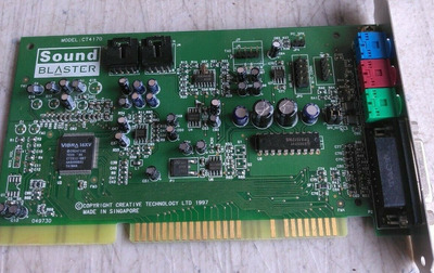

Reply 35271 of 40040, by pete8475
Got this in the mail today.
It's a Creative Labs Vibra 16X, tested in my K6-2 and works nicely.
I actually ordered this before I got the 2 free AWE64 cards so now it's not really needed, but doesn't hurt to have an extra ISA sound card in my box of stuff.
This pic is from the ebay auction, I have since moved the jumpers into the line out position.
    301.96 KiB
    527 views

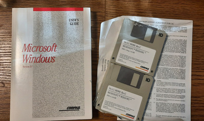

Not HW but I am excited about it anyways,
Windows 3.1 for Compaq PC with UK licence, sealed (not anymore). Nice six sealed floppies.
I would like to install this on my Presario 460

Reply 35276 of 40040, by pentiumspeed
The fan under the cards, don't use fan there. Just vents. Use 80mm or 90mm fan blowing out, the 140mm at top, also blows out. Less noise too. Anything else conflicts.
Honestly, this case is worst design for cooling unless you have side vents on the panel, if not, draw up one and use 2 sizes of drills make grid of holes. Let it be a intake to let air waft onto cards with two fans I mentioned blowing out.

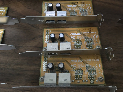

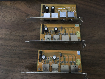

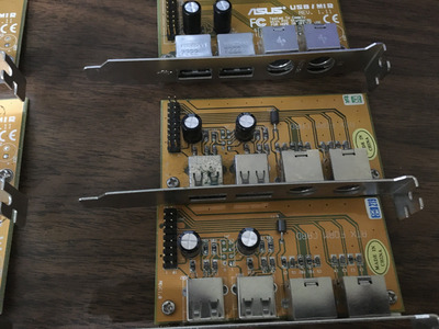

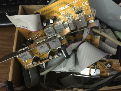

More freebies from the same friend (I've known this guy since 1997):
Several Asus USB/MIR cards (with PS/2!!!)
Various USB headers
Various audio cables
etc.
Going through the box of goodies now.
EDIT:
Took pics of the most interesting stuff.
3 x Asus USB3P
3 x Asus USB/MIR (usb only)
1 x Asus USB/MIR (usb/ps2/ir)
2 x no-name USB/MIR knock-offs (ATX form card is silk-screened on the PCB) Also one of these seems to have liquid damage / corrosion on one of the usb ports.
2 x PS/2 mouse headers
He also has an Asus P2-99B AT motherboard, but there is a blown capacitor on it, so I didn't take it.
    850.78 KiB
    420 views
    831.3 KiB
    421 views
    838.4 KiB
    421 views
    830.89 KiB
    421 views
    776.94 KiB
    425 views
