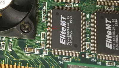

psychofox wrote on 2021-09-10, 17:31:
It works perfectly on text mode but there are these horisontal lines when windows boots up. Is it repairable?
Is it broken? Looks similar to some cards that "just do that" on LCD monitors in certain modes.
Reply 40444 of 52969, by wiretap
You'll want to boot up a DOS graphics mode test first to confirm for sure it isn't working in text modes. Also test both Windows and DOS 3D applications/games. Try different drivers. Try different refresh rates and resolutions in Windows. Try a different cable and different monitor.
But if it is a hardware failure mode, it appears to be color shifting vertical bars.. this indicates something in the video RAM is not be stored properly within the frame buffer. RAM replacement should solve that. Check all legs of the RAM chips first -- it could be something as simple as a broken solder connection or shorted leg too.

Reply 40445 of 52969, by BitWrangler
Only thing I can see off in the pic is on RAM chip bottom right of the fan, left row of pins, right in the middle, check that isn't a blob/flake of something conductive.
Reply 40446 of 52969, by wiretap
BitWrangler wrote on 2021-09-10, 19:59:
Looks to me like that pin is broken away from the pad, shifted downward toward the gold finger side of the card. It is definitely at a different angle than all the rest based on the light reflection.
1.49 MiB
2500 views
Should be an easy fix.. bend back gently with a fine sewing needle, then touch it with some flux/solder. Then test the card again.

Reply 40447 of 52969, by Intel486dx33
This weeks old HW picks arrived: […]
1. Voodoo Banshee I cant find any information about manufacturer or icc code. It works perfectly on text mode but there are these horisontal lines when windows boots up. Is it repairable?
2. This interesting Yamaha 751b-s sound card with radio decoder. Cant find any info or drivers for radio for this baby. Anyone has seen before such card?
3. NEC D5146h MFM hard drive. Powers up, i can hear heads moving, led flashes but BIos gives hdd error.
Great finds at first look but not so lucky at the end 🙁
Yes, Its repairable. I have fixed many Voodoo and Video cards with Artifacting.
Its most likely the RAM chips that have bad solder joint.
The RAM Chips are soldered onto the PCB using solder and baked in a special oven.
When these PCB Boards get HOT the solder joints break and causes these Artifacting and lines issues.
You can re-solder the RAM chips to the PCB board with a process called “reflow”
Get a soldering heat gun and set the temp to the melting point of the solder which is about 200 thru 400 degrees.
So check on what type of solder you are using. place some solder paste on the RAM chip legs and then heat with solder gun.
Let the solder paste do the work of repairing the solder joints. Don’t touch the RAM chips when soldering. Just let the paste
Do all the work. Clean area with solution or soapy water when done.
Let’s dry completely.
This should fix the problem. But the GPU chip is definitely NOT the problem.
When the GPU chip solder joints go bad you get NO video.

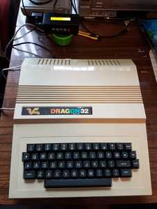

Reply 40448 of 52969, by PTherapist
Bought a couple of days ago from eBay and received today -
190.01 KiB
2422 views
71.78 KiB
2422 views
I've been contemplating getting a Dragon 32 for some time, but they've generally been selling for over £100 and many of the cheaper sales are lacking the AC power adapter and it's weird DB-9 connector.
Saw a listing for a Dragon 32 as "Untested" but noted that it had the power adapter so thought I'd take a gamble and got it for quite a reasonable price all things considered. The cherry on the cake of course being that it is actually working and just needs a good cleaning. The case badge is a little faded, but I'm tempted to just leave that as-is rather than replace it, adds to the vintage. 🤣
Now I can investigate on real hardware, the Dragon 32 games library & the Tandy CoCo ports.
Reply 40449 of 52969, by Nexxen
PTherapist wrote on 2021-09-11, 11:03:
There is a happy boy in the house 😀
These and other similar models have a very "nostalgia" appeal.

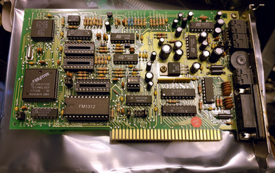

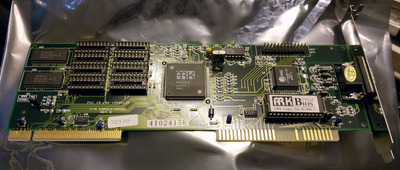

Reply 40451 of 52969, by imi
got in a nice lot today, some of the contents, the main prize at the end ^^
after a long and exhausting search, I finally got one ^^
289.56 KiB
2348 views
405.92 KiB
2348 views
242.41 KiB
2348 views

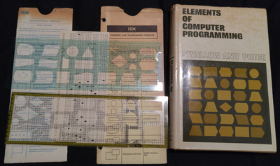

Reply 40453 of 52969, by BitWrangler
Nice stuff above peeps, congrats on those scores.
Now "they" say that if you can touch it it's hardware... I can touch the templates, and they're used to make software, gotta be hardware no? Then retro, book is published 1965 so figure they and the Hollerith coded punch card are dated between there and 1970, retro enough? Well these were all tucked in the book I thought was interesting, was practically free in a fill a bag sale. May use the templates, I've been meaning for a long time to design this control system that has multiple inputs and control outputs, and I do it kinda sketchy and get tangled up. So, maybe I'll try the bondage and discipline IBM way. Got out my secret decoder ring and figured out the card is just basically an ID, probably what the books owner had to put on top of the deck/stack/batch of cards they hammered out on the cardpunch machine and submitted to run on the machine.
Edit: Just noticed that the card has square corners, IBM introduced round cornered cards in 1964, so the card must be from early 1964 stock or earlier. It is therefore probable that the institution had a large stock of the old style cards to use up, or at least enough to last into '65 when the textbook was published. Possibly they got them donated from commercial users who wanted the uninterrupted high speed running that might be promised by the lack of snagging corners, so therefore retired their stock as soon as they could get the round cornered ones.
    601.02 KiB
    2265 views
    Circa 1965-70 programming tools
Reply 40454 of 52969, by bjwil1991
imi wrote on 2021-09-11, 16:09:
got in a nice lot today, some of the contents, the main prize at the end ^^ after a long and exhausting search, I finally got on […]
That SB 2.0 card is cool. I have one that has the CMS upgrade installed and it works well in my XT luggable.
Reply 40455 of 52969, by Byrd
The ARK1000VL? If so I just joined the club - same card but with empty DRAM sockets on far left. Seems a great fast card.
Reply 40456 of 52969, by imi
Byrd wrote on 2021-09-12, 00:56:
yup ^^ it's an elusive beast... and they sell for way way too much money
