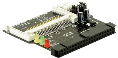

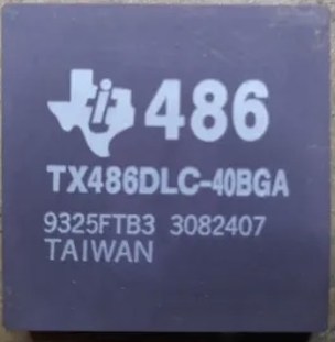

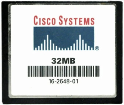

Bought two CPUs yesterday, one is actually an FPU, to upgrade a 386DX, I already have the same pair on another PC, but the CPU is Cyrix, I don't know if there is any difference between TI and Cyrix, when they arrive I will try doing benches, exchanging CPUs, we'll see how it goes.
I also took three IDE-CF adapters, and two CF cards of only 32MB, for these two memory cards, the use will be exclusively for the first DOS versions, and possibly for Windows 1.0X, to be used on PC 286 or 386SX.
Reply 48588 of 53152, by rasz_pl
PC@LIVE wrote on 2023-03-18, 09:02:
most likely pin 28 will be pulling ALE to ground and screwing with 286/386, needs modifying Re: "Fixed" 386sx motherboard works but not with 16-bit VGA card

Reply 48590 of 53152, by vstrakh
PC@LIVE wrote on 2023-03-18, 10:19:
So, I can only advise you to make several attempts, changing cards (assuming you have several), you may find the right combination
It's not about cards. The problem is in CF adapter. There is a mistake in PCB (maybe not on yours, but there is on mine, and on some other too), or designer acted on the assumption that the adapter will be used with the IDE controller that uses cable's pin 28 to signal Cable Select function. The line 28 on pre-CableSelect capable controllers (i.e. all those Multi-I/O ISA cards) carries different signal - the ALE. And the I/O card just passes through the ISA bus ALE signal to the cable. Grounding that line on the CF adapter breaks the ISA bus logic. The CF adapter must not drive the line 28 of the cable, yet it does, and it only works (not messes up with the system) if the IDE controller already grounded the line 28 on its side of the cable to use it as Cable Select line.
Reply 48591 of 53152, by kixs
Is there a list of problematic CF adapters? I have a few cheap adapters from China, bought in 2013/14 and never had any problems with them. Tested on 286 to at least some Athlon based computer. Different brand CF cards from 16MB to 8GB.
Reply 48592 of 53152, by PC@LIVE
vstrakh wrote on 2023-03-18, 11:00:
Ok I understood the problem, before I thought it was due to a fault, however it is possible that even the ones I have have the same problem, but the symptoms I encountered are different, as I wrote before, some old controllers do not detect the CF , and would it be possible that the PIN28 problem is the cause?
I solved it by changing the controller, but by mounting the IDE-CF adapter on more recent PCs, everything works normally, so no problem with 16-bit ISA video cards, at least with the ones I used, maybe it's just a problem with that motherboard with IDE-CF, because on my AMD 386SX 33MHz it works, ditto on the 386DX-40.
Reply 48593 of 53152, by vstrakh
This one is problematic: Re: Troubleshooting 386 motherboard, video memory writes clashes with PCM audio playback
Cutting the copper around pin 28 on the IDE connector solves the issue.
And you don't even know there is a problem, because on most of builds the issue does not manifest. It all depends on the tons of factors - the drive strength of the ALE signal, the speed of address latches on the cards that may survive the shorted ALE because it takes time for the pulse to reach the CF adapter and reflect back. Those +/- nanosecs may be enough to allow everything run smoothly, or it will fail because of edge cases on another build, and you will suspect your "faulty" video card rather than broken logic of the ISA bus.
Reply 48594 of 53152, by kixs
OK. Great to know if something weird happens. If testing a motherboard in unknown condition it's always better for the first power up to do with only basic setup - mobo + ram + vga.
Reply 48595 of 53152, by PC@LIVE
vstrakh wrote on 2023-03-18, 11:23:
Ok thanks, I didn't know about the PIN28 problem, as soon as I can I'll take a look at some adapters, I guess they are all connected to ground, I have various versions of adapters, one is dual CF, while the other 3-4 are to connect to the 40 PIN cable (Master or Slave).

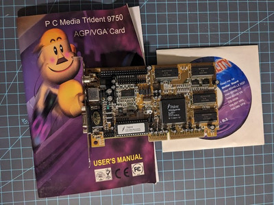

Reply 48597 of 53152, by Asininity
I'll admit it was the box art that drew me in. Now I just need to bring myself to actually use it.
