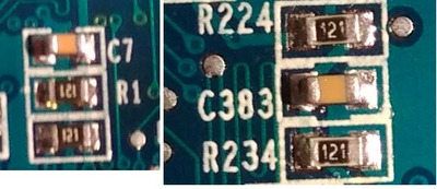

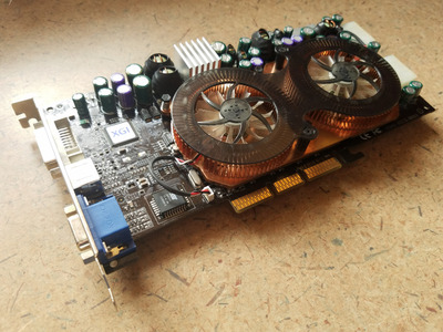

Hi, new member here, so I came across a listing for a bunch of FX 5500 cards: 1.jpg […]
the Chaintech card looked odd to me since it has a molex connector, these cards don't need external power and high end cards don't use cheap rams,
then I checked the Chaintech website and looked through their Fx series cards and couldn't find anything similar to this.
I contacted the seller and asked him if the card still is available and he said card shows artifacts and he was going to scrap it.

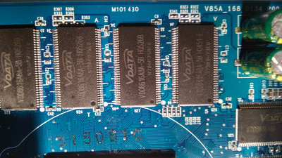

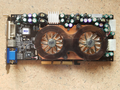

I bought it and it was actually a XGI Volari V5 card:
it works but there are vertical lines all over the screen. after cleaning and inspecting, I found 2 knocked off caps and a ram chip was cracked.
It didn't look this bad before I start poking it with tweezers, 🤣.
now waiting for the replacement ram chip.

Reply 48683 of 53150, by Karbist
Ozzuneoj wrote on 2023-03-28, 14:09:
Wow, fantastic find!
I hope you're able to get it working.
If you don't normally do chip replacements like that, I would suggest practicing on less rare cards first. If you know what you're doing though, have at it! 😀
Well the ram chip arrived:
1.54 MiB
1653 views
two tiny 100nf caps are back at their places:
48.71 KiB
1653 views
now it's a happy Volari v5 completely artifact free, yay.
213.26 KiB
1653 views

Kahenraz wrote on 2023-03-29, 13:12:
How did you figure out which RAM chip to replace? Did you replace them all or one at a time until the problem went away?
One chip was visibly damaged. See Re: Bought these (retro) hardware today
