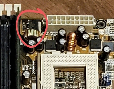

I had a really easy repair once. On visual inspection, the board looked fine, but it wouldn't POST and the CPU barely got warm. I started touching the VRMs to see if they were heading up and the system sprung to life! In this case, the VRM had detached from the motherboard, which was its ground connection. This was surprising, because that's typically a very strong connection once soldered.
Curious to know which component on the VRM detached. Was it a mosfet, capacitor or something else?
Sounds like it was a Mosfet, typically its soldered directly to the ground plane, on most its a just the source pin going to a pad but other larger fets have the connection as a pad on the rear of the Mosfet and its soldered to a large square ground pad under the fet to provide a stronger connection. I'm guessing this attachment under the fet has cracked and touching it allowed to to connect again.

Reply 52024 of 53069, by Kahenraz
zuldan wrote on 2024-03-05, 03:09:
Kahenraz wrote on 2024-03-05, 02:38:
It was this component here.
Maybe the mechanical strain from removing the ATX power connector caused it break loose as the board warped, just enough.

Reply 52025 of 53069, by Trashbytes
Kahenraz wrote on 2024-03-05, 05:31:
Trashbytes wrote on 2024-03-05, 03:12:
Sounds like it was a Mosfet, typically its soldered directly to the ground plane, on most its a just the source pin going to a p […]
https://oscarliang.com/how-to-use-mosfet-beginner-tutorial/ is a basic run down of a Mosfet
-corrected some things
Thanks for the information. I can never tell the difference between a VRM and a Mosfet, unless it's standing on its legs with a large heatsink on it, that is.
VRM isnt totally incorrect, Mosfets are just a part of it. (Not all three legged parts on heatsinks are fets !)
That little one looks like a Fet, you could just reflow it to reattach it, though you could also replace it and fix it to a small heat sink so it doesn't break away again. Ive seen this done with GPUs that have a similar setup and changing it so the fet is on a small heatsink helps tremendously with both longevity of the fet and better stability as the fet now has better cooling.
Reply 52026 of 53069, by Kahenraz
I can't stand it up since it only has two legs. The third "leg" is the back part that was soldered to the board, which is what broke away. I suppose it would be possible to run a wire from the heatsink. That would be interesting to see.
I have this motherboard in storage at the moment, but maybe there is an unused hole for the third pin that can be used instead with a similar part. This while idea would be interesting for modifying 440BX motherboards with MOSFETs that are overdriven.

Reply 52027 of 53069, by Trashbytes
Kahenraz wrote on 2024-03-05, 06:47:
I can't stand it up since it only has two legs. The third "leg" is the back part that was soldered to the board, which is what b […]

You simply replace it with a 3 legged model, so long as the replacement has the same specs. Ive seen it done a few times now and it does work, helps the fet to live longer too as it now has a way to dump heat that isnt into the ground plane of the motherboard.
The issue with just reflowing it or re-soldering is that eventually it'll break again via the same failure mode.
Reply 52028 of 53069, by Kahenraz
I ordered this during the winter. My guess was either mechanical stress or thermal stress due to expansion over the years and possibly one final contraction due to the extreme cold. I seem to recall the seller saying that he had tested it before shipping, and was surprised that it was DOA.
It's good to have a list of possible failure modes that are easy to test and diagnose. One of my motherboards I pulled out this past week seemed completely dead... until I realized that I'd inserted the IDE cable backwards into the motherboard. After turning it around, everything worked a treat. Sometimes the failure mode is me.

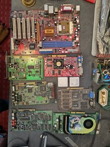

Got this lot in today from my usual place, all sold as untested:
637.22 KiB
778 views
PC Chips M848A SiS chipset socket A motherboard + Athlon 2400+. Judging by the size of the die, it's a barthon CPU, but as far as I know the only 2400+ with a barton core is a Mobile variant, and I highly doubt this is one of those. Most likely it's a defective barton core limited to 256k of L2 cache. Untested. The motherboard is missing a couple of SMD caps on the back of the northbridge.
The red AGP card is a bog standardard low cost 9600XT with 5ns video memory. These make prety good GPUs for quick-and-dirty cheap win9x builds, unfortunatly this one is artefacting.
The ESS card has a wavetable, witch peaked my curiosity. I haven't identified it yet.
There's also a Mediavision card, haven't tested it or had a good look at it. Seems to be a Pro Audio Spectrum / Pro Audio Studio 16.
Voodoo 1 is untested, seems to be a Biostar or Skywell. No missing parts, no bent pins.
The roland card appears to be an SCC-1. I don't know much about it, apart from it's supposed to be sort of an internal version of the SC-55.
The 6 series AGP card is an EVGA or MSI 6800GT. It posts fine, no artefacting, driver installs, but when launching 3dmark01 my test PC froze and I got a checker pattern on screen. Possibly bad VRM....

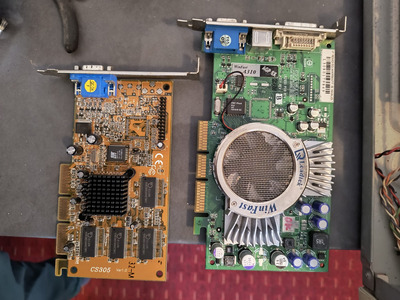

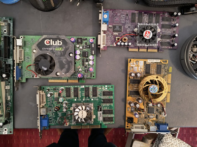

The 6600 AGP is missing a couple of SMD caps on the back. Some really tiny ones too, hope my hand is steady enough to replace them.
The purble card is a Palit Radeon 9100 - essentially a rebranded 8500.
Leadtek a340 is an FX5200 FX5500. This card has 4ns ram. Also missing components. The fact that Leadtek names both the 5200 and 5500 "A340" is a bit confusing, but you can tell the cards apart by how fast the ram is. 5200's usually has 5ns ram, while the 5500 uses 4ns memory (at least the leadtek A340 cards do).
The orange card is a Pixelview/Asus FX5600XT. Missing SMD caps on the back...... again. Like all the rest of my 5600's. Apart from the Leadtek below.

Leadtek FX5600 - I've been looking for a WORKNG 5600 for years now, and apart from this card, all I have to show for it is a pile of defective 5600's (missing parts). This one works. Scored close to 11000 pts in 3dmark01 with a 3.2GHz LGA775 pentium 4. So cool to finally see one of these in action for myself.
The tiny riva vanta looking card is a SiS 305. It pots, but as soon as XP starts up my test LCD displays "out of range". Really dirty VGA output. I'll retest it with a CRT or a multisync monitor.

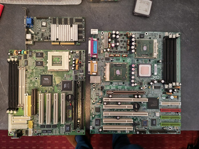

Acorp VIA MVP3 AT form factor. Looks to be in great condition, haven't tested it yet.
On top there's a voodoo 3 3000. Seems to work ok.
The dual CPU board is a Gigabyte GA 7DPXDW-P. It's in good condition, but it will shut off seconds after turning on. I did get it to ask for ram (POST beeps) a couple of times. The marked caps are not bloated, they were leaning to one side exposing part of the plates to air. I'll pull them off and retest the board. The Northbridge heatsink is missing. I also have no Athlon MPs in my collection, so I hope it will post with a single Athlon XP. The 2600+ CPUs in it now are a bit much, but it's the only matching pair I have.
AT the top all the way there's a pair of K6-III 400's with slightly bent pins. K6-III's are allways nice to have.
