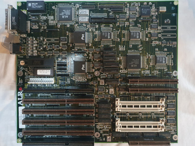

Reply 56803 of 56992, by kinetix

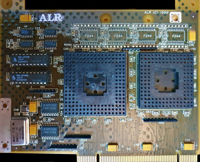

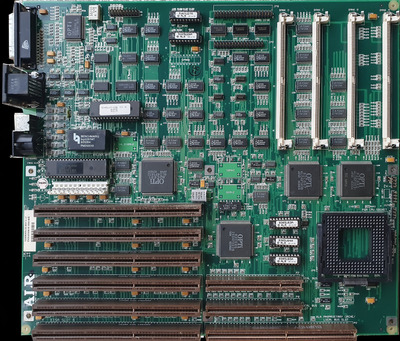

After a year and a half of acquiring them, cleaning them, sending photos and data to Theretroweb, and keeping them safely stored, I'm preparing my two ALR motherboards to test them in a few days.
It's a shame I couldn't find the cache cards for either of them. I will test them with a DX -33 and a DX2-66.
The best things is that I didn't buy them; it only cost me some time to sort through a pile of things that were going to be recycled. Maybe the cache was there too, but I couldn't find it. I almost couldn't even find the CPU card of one of them.
It's a shame I doesn't have EISA cards either. It would be something interesting to try. I've seen few reports, articles, or videos of tests with EISA cards. The interesting thing about theisALR Evolution 4 EISA mobo is that it also has VL-B. Necroware made a couple of videos on the subject a while back, but I feel he fell a bit short on testing. Perhaps someone should do some well-calibrated tests of ISA vs. EISA vs. VLB vs. PCI. Let's say, something like cards that use the same chip/memory but on different buses. In my opinion, the worst thing about EISA is the same thing that's bad about MC: the need for specific configurations.

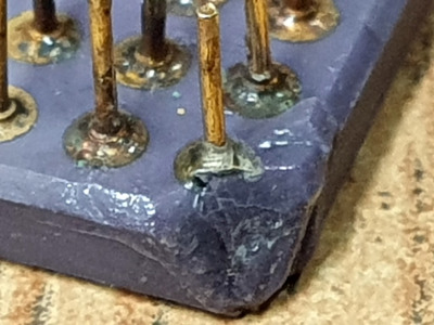

What I did bought for $2 was an IBM (Cyrix) 486 DX4-100, with oxidized and bent pins and one broken pin. The break included the corner of the ceramic, but incredibly the pin was still attached and connected!!!. Very carefully I straightened it, fitted the fragment into the crack in the ceramic, and applied superglue. I cleaned all the pins by gently scraping them and applying rust remover, until they were good enough. While doing this two pins fell, so I solder them back. the rest of the pins feels well fitted, and all connected. I still have to test this chip (taking the picture, now I see it need a little more cleaning, there still some rust).
Reply 56804 of 56992, by Horun
kinetix wrote on 2025-05-20, 00:08:
Good work ! I would never test try it in a PGA socket, might break all that work. Would test try it in a ZIF socket. Just my thoughts....

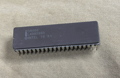

I have added a huge, yet small piece to my collection of CPUs. A genuine Intel 8088, in ceramic to boot. I already have an AMD 8088-2 and a V20 in my XT, but this is just special enough to make me happy.

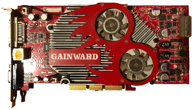

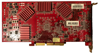

Got this nice Gainward FX 5900XT GS, needs a good clean and new paste but appears to be in ok physical condition.

its no FX 5950 Ultra but it should OC nicely being a golden sample and wont be that much slower for the games i want to throw at it.

Trashbytes wrote on 2025-05-21, 11:26:
I was watching this listing, but decided to let it go. I'm happy to see what it ended up in the hands of someone here on VOGONS. Good job. 💪

Kahenraz wrote on 2025-05-21, 11:48:
I wasn't sure if I was going to jump in, had been watching it shortly after it got listed .. but threw a bid at it in the last hour, honestly expected it to go for more than it did.

It was still pretty low at the last 15 minutes when I stopped watching it. Sometimes I have to remind myself that I already have plenty of video cards and tap out. If it's something I was sure that I could snag for sure closer to $50, I would have snapped it up.
Got this nice Gainward FX 5900XT GS, needs a good clean and new paste but appears to be in ok physical condition. […]
Oooh that is sick! Don't think i've ever seen a GPU with that kind of fan configuration. 😀

Trashbytes wrote on 2025-05-21, 11:50:
Nice! I hope it works for you! I didn't jump in because it smells dead, but maybe its just the crappy pictures that makes me feel that way.

AGP4LIfe? wrote on 2025-05-21, 22:00:
It certainly needs some TLC and some screens of it working would have been good but I've seen worse work out of the mail.
