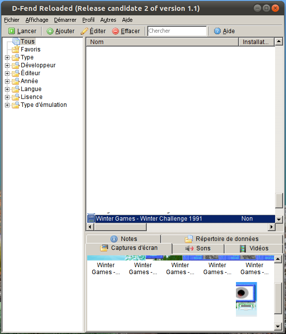

Reply 1435 of 2280, by sst

I use = D-Fend Reloaded, "1.1 RC 2", D-Fend Reloaded PortableApps package.
@Alexander
See file attached, ...
Problem with ScreenShot = not displayed correctly.

@sst:
I cannot reproduce this graphics problem. May be this is a problem of the Wine graphics driver?
