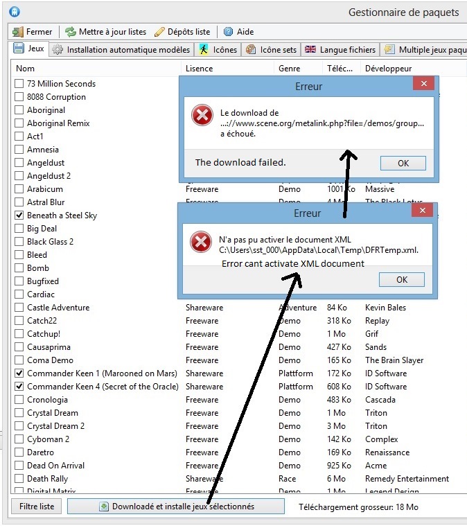

I use = D-Fend Reloaded, "v1.3.3", Portable structure.
I have a completly new install, of = D-Fend Reloaded, "v1.3.3", Portable structure.
I have some errors, ... see file(s) attached.
1 ) Error cant activate "XML" document.

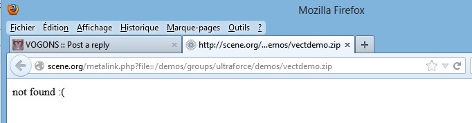

2 ) Error download failed. (it seem "http://scene.org/", have updated some url, inside the website "http://scene.org/".
"Vector demo" = error download from metalink.
Please look at = http://scene.org/file.php?file=%2Fdemos%2Fgro … mo.zip&fileinfo
other link formats:
* get .metalink
    170.8 KiB
    3732 views
    34.16 KiB
    3732 views

@sst:
It looks like the scene.org metalink demo download function is down. That's very sad but there is nothing I can do about this.
