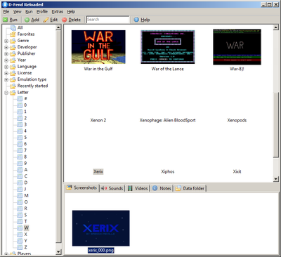

I've hit a problem when trying to view games in Screenshot mode. If I try this view (which has been working fine up until now) the "user defined information" fields start to cross one another and half of games it can find do not displaying their thumbnail images or pop up in the wrong field. (Please see attachment to make sense of this rambling).
I'm getting an error message stating "Access violation at address 004F6379 in module 'DFend.exe'. Read of address <variable 8 letter string>" for games catalogued under W and a different address message for games begging with X.
I've tried looking in this thread but there's over nine years of posts here. Could someone link me to a post?
Using DFR v1.4.4 Portable
    109.48 KiB
    23988 views
    Games beginning with X are now showing in W's user defined information field and thumbnails not showing for game.
