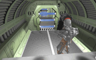

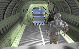

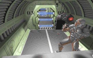

Reply 10 of 21, by MiniMax
Rank Moderator
Moderator
No such problems here. Default 0.72 config produced the following on Windows XP:
    25.94 KiB
    1553 views

Reply 12 of 21, by MiniMax
Rank Moderator
Moderator
I think I ran it 2-3 times, no problems at all.
Are you on Windows? Linux? Mac?
What kind of graphics card?
Tried different output modes in DOSBox?
Tried tweaking the hardware accelleration in your graphics driver?
_________________
