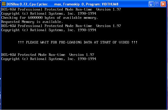

I decided that i wanted to install CM2 Italian League Edition and used DOSBox to do so. I looked at the 60 sec guide from a previous post on here to set it up.
It installed fine but will not run.
i typed the following commands into DOSBox:
mount C "C:\Documents and Settings\User\My Documents\DOSBox stuff\CM2_ITA"
mount D "D:\" -T cdrom
I then switched to the C:\ drive and firstly typed "GO.bat" then "CM2.exe", both started to run it but then the DOS box disappeared.
Any help much appreciated??

Reply 2 of 8, by bullseye44
it didnt make any difference when the "t" was lower case.
when i mounted both drives and then typed "GO.bat" the box changed as though it was starting to load (see image) then disappeared.
Why would i need to start DOSbox from a CMD prompt?

Reply 3 of 8, by MiniMax
Rank Moderator
Moderator
Because it is not helpful when DOSBox closes without a trace. When started from a CMD-prompt you stand a better chance of catching any error messages from DOSBox.
So - can you start DOSBox from CMD-prompt?

Reply 5 of 8, by MiniMax
Rank Moderator
Moderator
bullseye44 wrote:
I might be being a little stupid here but if i open a cmd prompt (wich i can by typing cmd in the run box) isnt that just the same as running dos box?
No.
Do this:
Run => cmd.exe
C:\>cd "%ProgramFiles%\DOSBox-0.72"
C:\>dosbox.exe -noconsole
Start CM2 and wait for DOSBox to disappear.
C:\> type stdout.txt
C:\> type stderr.txt
Then tell us what stdout.txt and stderr.txt contained. You may also open them in Notepad if you prefer that:
C:\> notepad stdout.txt
C:\> notepad stderr.txt

Reply 6 of 8, by bullseye44
stdout.txt
DOSBox version 0.72
Copyright 2002-2007 DOSBox Team, published under GNU GPL.
CONFIG:Loading primary settings from config file dosbox.conf
MIDI:Opened device:win32
Exit to error: CPU:GRP5:Illegal Call 7
when i typed stderr.txt it did not find it.
