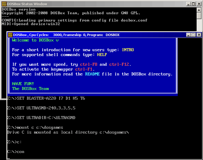

I don't know whether this happens in all versions or just the CVS build I tested it in, but executing the command "con" freezes the shell with no way to exit. Ctrl+C or Ctrl+Z won't get out.

This only happens under certain (and curious) circumstances, and perhaps also only on a Windows host OS. I only tried it as far back as 0.65, but it happens on every build I've tried.
1) It only happens if you have a console window open. If you run DOSBox with the -noconsole switch, you always get "Illegal command: con."
2) It only happens once you've mounted a DOSBox drive to the local "C" drive. It's curious that only the "C" drive is affected. If you have a drive mounted to local "D", it will not happen unless there also is a drive mounted to "C".
According to the log message in debugger builds, DOSBox is attempting to execute "con.COM" after parsing the command.
With all of that said, "con" is not a DOS command. It is a reserved name for the console device, and generally speaking the OS shouldn't allow a program to be named similarly to a device (CON.COM or CON.EXE are illegal names). The problem, if you want to call it that, is probably that DOSBox is parsing the command in such a way that it finds the console device and therefore thinks it exists as a file and attempts to execute CON.COM, resulting in a hang. But again, this is likely only to happen on a Windows host OS where the console device name has special meaning.

Reply 5 of 20, by ripsaw8080
Rank DOSBox Author
DOSBox Author
Not much to see in a picture, but I've included the status window to emphasize its importance in the issue. Latest CVS build on Windows XP SP2 32-bit.
