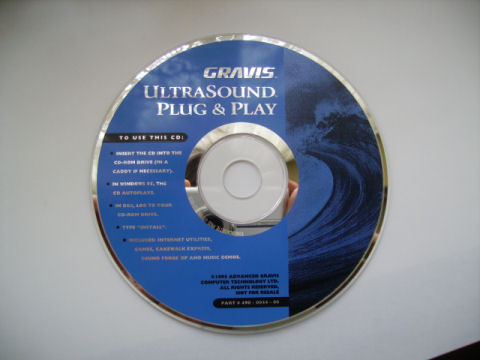

Reply 7 of 25, by retro games 100
I am wondering if I have been given the correct CD? (Please see 2nd photo)
I am using a GUS PnP Pro, with 8mb of extra RAM. But the CD doesn't mention the word Pro. Also, in the first photo, there's no mention of the word Pro on the manual.
Also, I can't find any installed software that will allow me to experiment with different patch sets.

Reply 8 of 25, by Amigaz
The install should be fairly simple.
The cd looks just like mine.
So everything works except you think the digital part sounds cheesy when playing games that have native GUS drivers in DOS?
