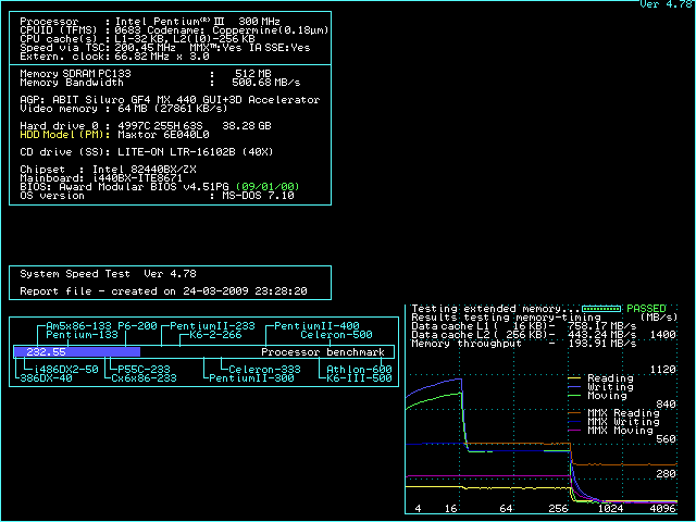

It took some time, but some days ago I received the Engineering sample CPU. It is a Coppermine Pentium III 750/100, product number QH31ES Cpu world info.
The bad news: It does not respond properly to Multiplier setting 1.5x, 2.0x and 2.5x. With these multipliers it sets itself on a higher setting, with some odd readings in speedsys.
The good news: It accepts all the other multiplier settings I could throw at it. 3.0x to 8.0x. And the caches seem to work properly at all these settings. Attached the SpeedSys benchmark at 200Mhz ( 3.0x and 66MHz FSB).
It is nice to have this slow speed setting available, though for speed sensitive games one certainly needs additional slowdown methods. When set to its full speed, a Coppermine CPU is an all-round good performer: Fast 32-bit+16-bit, fast Integer+FPU, MMX+SSE, fast cache and reasonable power usage.
PS. my Aopen mainboard detects the 100MHz bus support and won't let me choose 66MHz in the bios. So that can also be an obstacle in slowing down similar systems.
    12.19 KiB
    3952 views
    QH31ES SpeedSys benchmark at 200Mhz (3.0x and 66MHz FSB).

Another thing: Although coppermine CPU's are found with 256kB L2 cache, until the release of the Tualatin-S versions with 512kB. The seller of the QH31ES stated it to have 512kB L2 cache, and CPU world also shows an image of a QH31ES mentioning 512kB L2? On the other hand Speedsys and CPU-Z detect 256kB on mine. I am afraid it just doesn't have the extra cache.
Edit: the seller assured me the CPU showed 512kB L2 when using it on his Abit BH6 mainboard...
