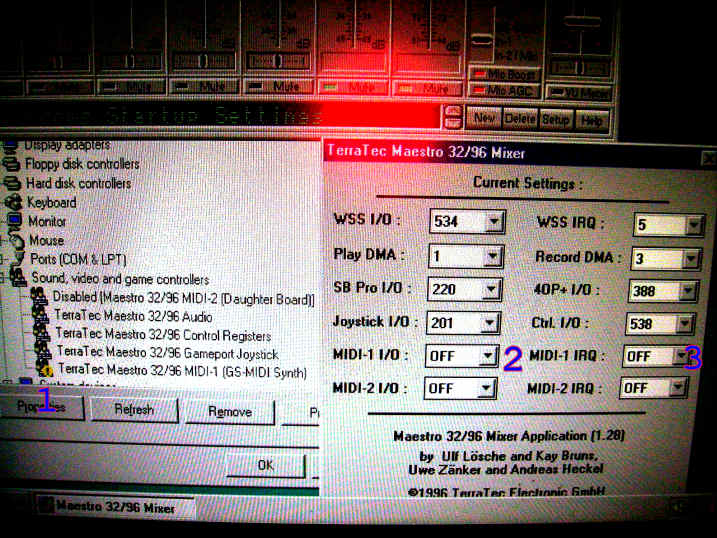

I got the chance to test another terratec maestro 32/96 today. But this one looks in bad shape - bent pins, strange marks on the caps, general "bashed about" look to it.
After installing the drivers & software in Windows 95, I can get SoundBlaster Pro sound effects, but nothing else - no FM, no general midi.
On the photo, where it says "1", the MIDI-1 device always has a yellow ! icon next to it. On the photo, where it says "2" and "3", I try and assign those two MIDI-1 input fields some meaningful values such as 330 (I/O) & 7 or 9 (IRQ), but after a reboot, those two values are always reset back to "OFF".
I am testing this card on a UM8810PAIO rev 2.1 board (a good old 486 board), with a phoenix PnP BIOS (ver 4.04). I have the BIOS's PnP OS value set to "Yes".
Any ideas please people? 😀

Did you check/set the settings with the tool in pure DOS that changes the settigs in the cards EPROM?
I think it's called "Terratec.exe"

Follow Amigaz advice.
If you can configure the card in dos, turn the "pnp OS" option to "no".
You could also try to set the values for DMA/IRQs to legacy isa (if this is possible with this board) and look what happens.
I bought this card some time ago on ebay in its original package with a sticker on it "now plug and play!" So I wonder if there ever was a non-pnp version of this card (which would require to reserve its recources in the bios).

I changed the BIOS's "plug n play" setting back to "No", and then booted-up the machine with a bootable DOS disk in the floppy drive. When the BIOS performs its POST operations, it displays these 2 lines on the screen:
Resource Allocation failure - PnP Device Terratec Maestro 32/96
Resource Allocation failure - PnP Device CTRL
Once at the DOS prompt, I ran the configuration utility called "terratec.exe", I saw a brief message saying something like !!!FAKE PnP BIOS detected!!! (something like that), and then saw the main terratec configuration screen. I then tried the diagnostics section, and tested the WSS, but this locks up the machine. I tried changing some of the WSS resource values, such as changing IRQ 5 to IRQ 7, and I also tried changing its DMA resource values to 0 and 1, rather than the default 1 and 3, but retesting the WSS still locks up the machine.
When changing those values mentioned above, I was just picking random numbers "out of thin air". I tried running "msd" at the DOS command prompt, but DOS couldn't find this utility. I must find out what resources (IRQs and DMAs) the mobo is using, because picking random numbers for these important IRQ and DMA values is just plain stupid (of me).
Also, when I installed the Maestro software, I installed 2 different versions of the software. One was a single "windows 95" .exe, and the other installation was a 4 part DOS zip package. (All this software was downloaded from terratec's FTP maestro 32/96 folder.)
I seem to remember getting in to a nice mess with my first terratec card I tested, then after about 3 installation/uninstallations later, it magically fixed itself. Hehe.
Edit: I found "msd". I booted up with another HDD with DOS 6.22 on it, and found this utility inside the C:\DOS folder. I couldn't find it earlier, because it might not be included with Windows 95. Incidentally, if DOS has "msd", and Windows 98 has that utility called "system resources" (or whatever it's called), then what does windows 95 have, in order to examine your system's IRQ and DMA resources, etc?
