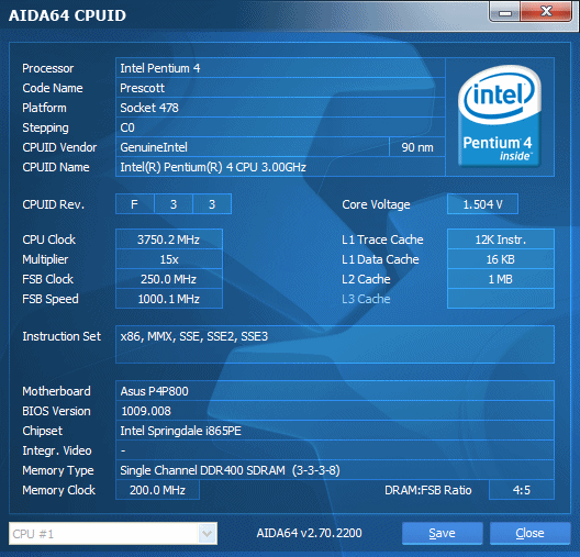

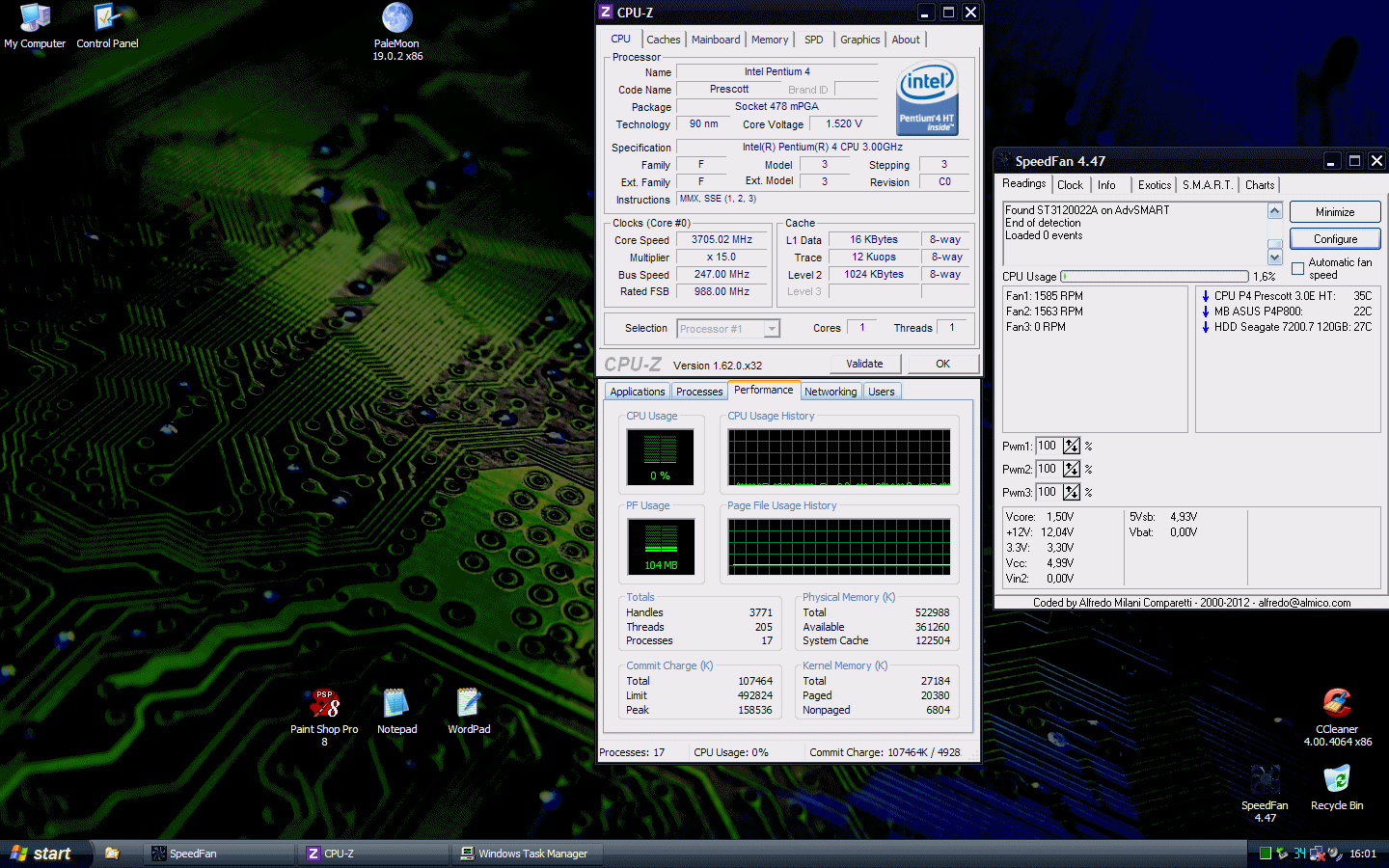

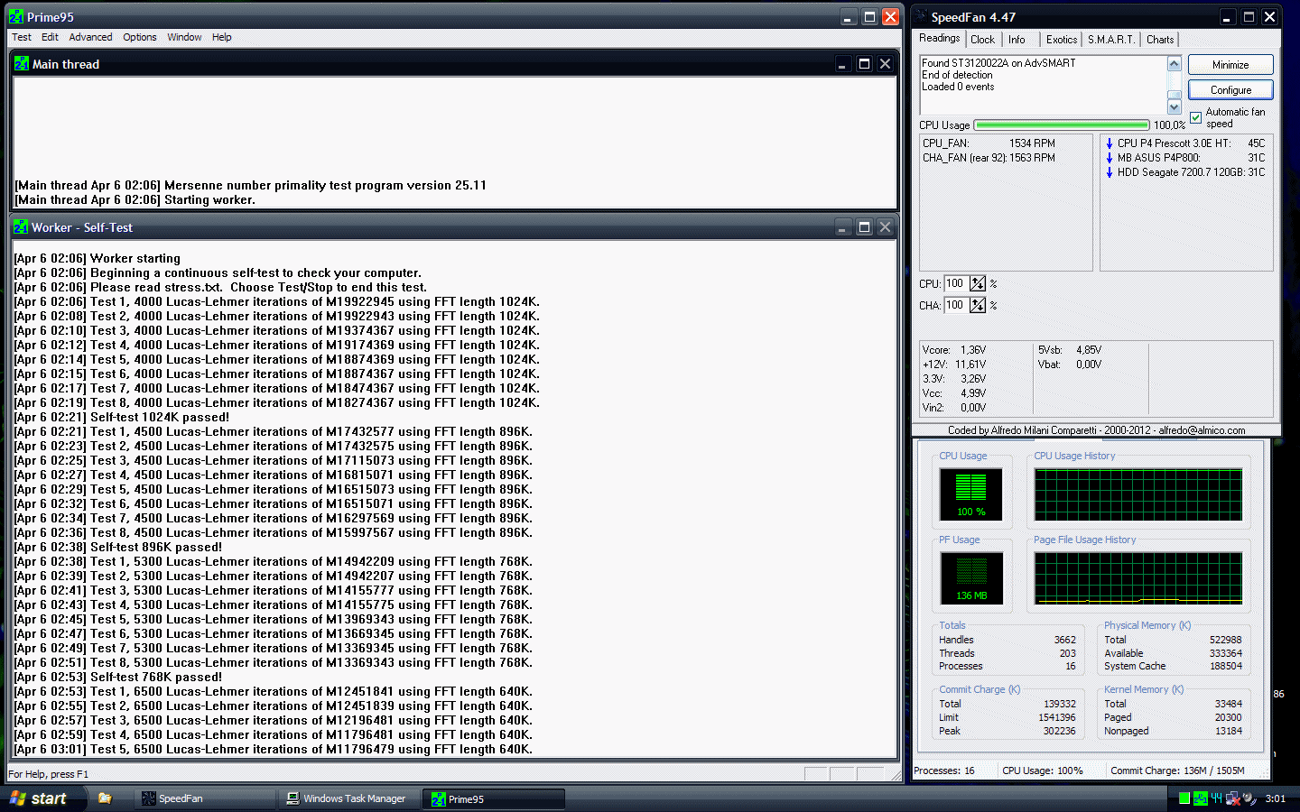

Man, this makes me really nostalgic. Here's my 3.0E e0 @ 4ghz.
Had to raise voltage because I'm having a lot of Vdroop at full 'burner. Not sure if the culprit is the mobo, the PSU, or both.
Amazed you reached 4.0GHz with just 1.344~1.36V 😲 .

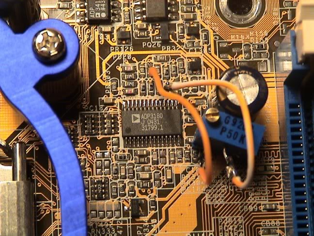

wrote:Had to raise voltage because I'm having a lot of Vdroop at full 'burner. Not sure if the culprit is the mobo, the PSU, or both.

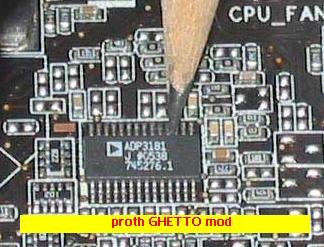

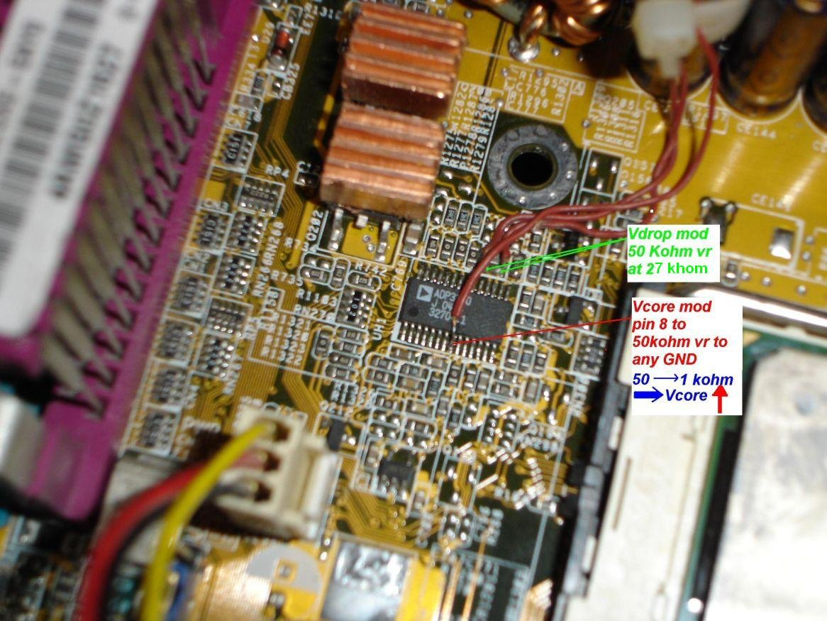

its the motherboard. The Asus motherboards at the time were NOTORIOUS for this. But if you could solder in a precision resistor, this was virtually eliminated. I did the "droop mod" for my p4c800e-dlx back in the day.

Yes. Follow the directions exactly for your motherboard. The droop on vcore should be reduced by 75%.

Considering my at best average soldering skills and big paws I concluded that trying to solder on small & fragile SMD components would be recipe for disaster. So I looked for unconventional warfare alternatives.
... as the resistance needed to be added is very low, graphite can be substituted in place of a variable or fixed resistor(s).

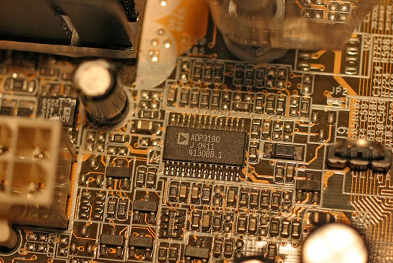

Simply use a pacer (mechanical pencil with a thin tip) and 2H - 2B graphite, and lightly shade between legs 17 and 18 of the ADP 3180 chip. Check vdroop, add more graphite if droop still unsatisfactory, or if vcore rises under load, remove some graphite with a paintbrush or cotton tip ...http://www.xtremesystems.org/forums/showthrea … ncil-Vdroop-mod
This is as ghetto as they come but works like a charm, after some penciling the max Vdroop I see now is ~0.02 V .

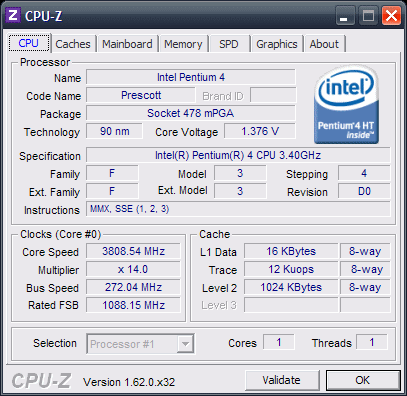

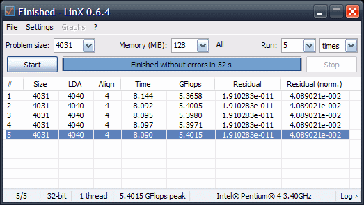

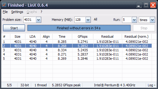

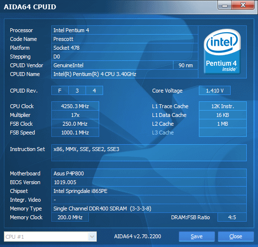

Then replaced the C0 stepping 3.0E with a D0 stepping 3.4E, lapped till it smiled, and began tormenting. For some reason (from what I've read it could be some P4P800 protection feature) the 3.4E gets a x14 multiplier, instead of x17:

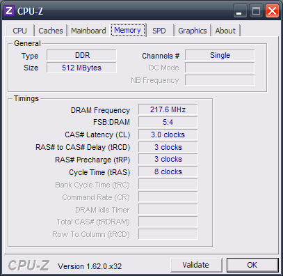

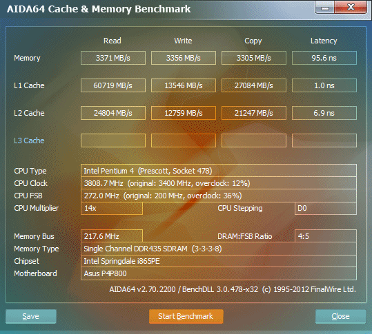

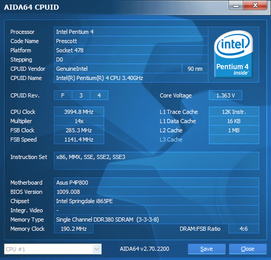

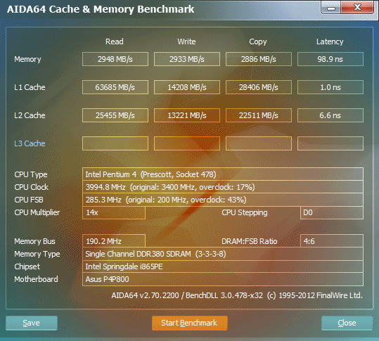

@ 4GHz the infernal beast gnaws 5.4 GFlops, but at 4:6 divider memory performance drops below 3000 MB/s reading:

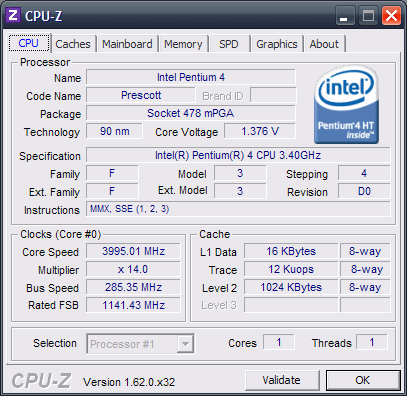

So I think 3.8GHz at 4:5 divider is a better compromise for now:

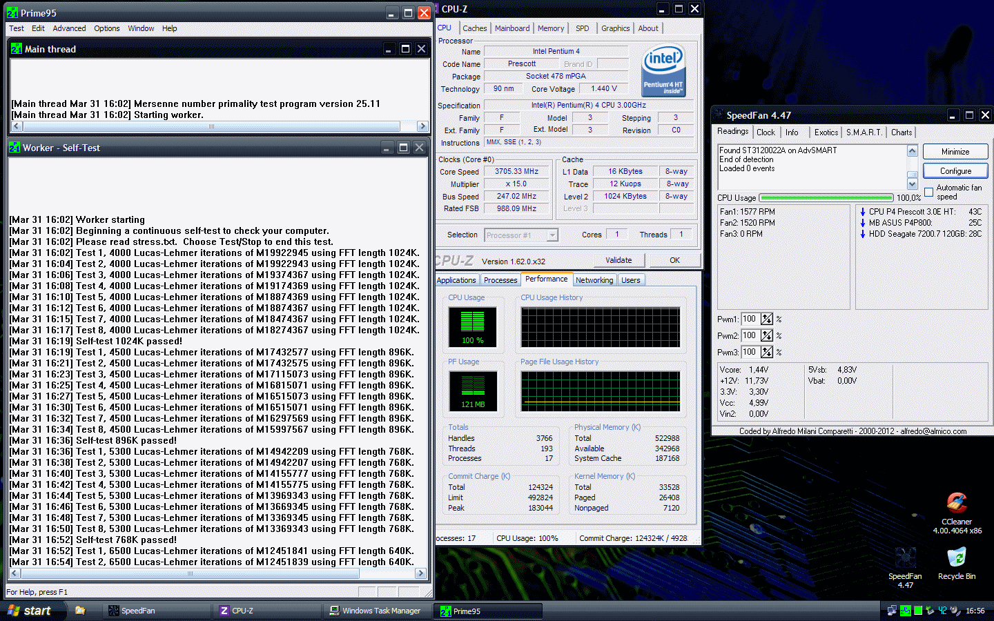

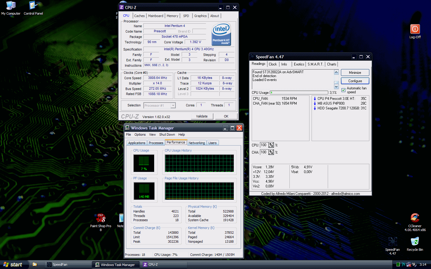

@ 3.8GHz & 21C ambient temps are 35C idling (Δ14C) and 45C burning (Δ24C):

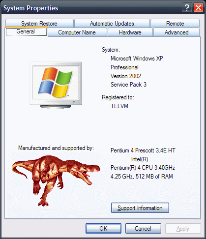

Solved the 3.4E multiplier problem with a BIOS update, now is this son of a beast beggining to roar decently 😈 .
The ~300W PSU is now the weak link in the chain, lots of +12V droop at full 'burner 😵 .

What's the deal with all these dinosaurs I keep seeing in those screenshots? Is there a Jurassic Park XP edition I'm not aware of? As if good ole XP wasn't prehistoric enough in itself 😁
It's the new Windoze Blew, you touch, it bites 😁 .

wrote:The ~300W PSU is now the weak link in the chain, lots of +12V droop at full 'burner 😵 .
300w!!?? You need moar power- a good 450w unit would do it. Might be able to crack 4ghz stable then.
