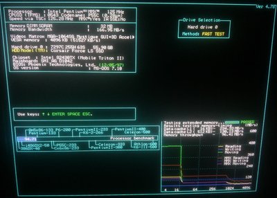

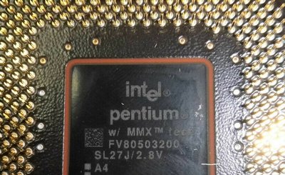

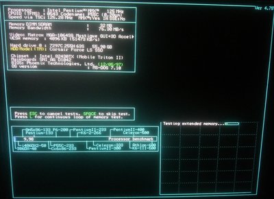

Reply 26 of 26, by kodi
gerwin wrote:
Pentium MMX 200 SL27J 5.4.3 - 2.5x, 3.0x
just for the record with that one I can get it working on: 120Mhz, 150MHx, 180MHz and of course 200MHz.
Pictures of the CPU and screenshots from SpeedSys are attached.
On 120Mhz with cache disabled it goes does to 386DX 40Mhz.
So, those are the modes - 4 possible speeds and with cache disabled depending on the speed it is between 386DX 40Mhz and 486DX2 50Mhz (it cannot reach that speed and it's less than that and so maybe it's more correct to say between 386DX and 486DX 40Mhz).
