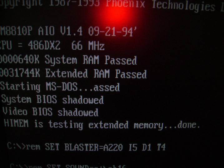

I noticed that a lot of the jumper settings on the board are not in their correct positions, regarding the CPU type and speed. I examined the help information printed on the board, and altered quite a few jumpers, in an attempt to set up an Intel 486 DX2-66 chip. After doing this, I turned on the power, and saw this on the screen -
Edit: Look closely for some humour.

I was becoming increasingly suspicious of my CPU. It was an Intel 486 DX-2 @66. I was becoming suspicious of it, because it came from the "evil acid machine". This was a box I was testing earlier which had a leaky Vanta battery in it. I removed it from my current test mobo, changed this CPU over to an Intel 486 SX @33, and now the SB Pro test utility can correctly "see" the card's DMA setting, which is currently set to 3.
Edit: I re-ran DOOM setup, and although it doesn't lock up any more with the soundblaster sound effects activated, they sound extremely poor. Something is still wrong somewhere, although the SB Pro test utility could play all of its test sounds ok. Strange. 😕
Edit 2: Is there a program I can run on this old 486 board (in DOS), to tell me what resources are currently in use? On my windows 98 box, I just go to "system resources", and I can see what IRQs and DMAs are in use. I just can't figure out why DOOM can't play sound effects. It also locks up the machine, if I choose any DMA other than 3. Thanks.
