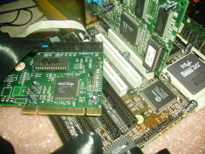

I'm trying to get an old mobo to work with a modern IDE hard drive. (Any "gotchas" to look out for?)
The mobo is a UMC chipset-based board, model TK8881 FA20, and can be found here -
http://www.elhvb.com/mboards/adi/tk8881/TK8881man.html
The photo shows the controller card sitting on this mobo, next to PCI slot #2 where I tried it.

I get strange results - the BIOS behaves oddly. Each time I boot-up, the BIOS appears to behave differently - something's not right. Sometimes the card is not seen at all. Other times, the HDD attached to the controller is seen, but then the BIOS hangs. Other times, I am given the chance to hit F3 to enter the controller card's set up section, but then I can't quit this set up area because I think the BIOS has locked up again. Basically, the BIOS is unhappy about this card.
Is the problem due to a potential mismatch of PCI specification, between the mobo and the controller card? Also, I have used SeaTools for DOS to limit the HDD's storage capacity. I think this is called an "overlay" - would that confuse either the controller or the mobo's BIOS? I've tried various IDE cables - one 40 pin, two others were 80 pin. (Also, there are a couple of jumpers on the card, whose purpose is unknown to me.)

Tried to disable the onboard IDE controllers as well? The setting for this should be in one of the "advanced" sections.
retro games 100 wrote:
Incidentally, does it matter that the controller card featured in the photo has 2 slots cut in to its PCI slot section? Does it mean anything? Is it important?
Nope. these notches are there to prevent inserting PCI cards into slots which don't provide the correct voltage. Your card is an universal 32-bit PCI card and should work in any PCI slot. See here for more details.
When I get access to the Raid controller's BIOS section, sometimes it behaves strangely. The Raid controller's BIOS appears to "see" the HDD, most of the time anyway, but the mobo's BIOS usually locks up after I try to boot-up the machine.
Looks like a resource conflict with the onboard IDE controller. It's also possible that the controller requires a newer PCI revision than available on the mainboard. 486 chipsets are often buggy in that respect. Try to find out what the jumpers on the controller are for. Maybe you can disable some of the more advanced features on the card (busmastering, etc...).

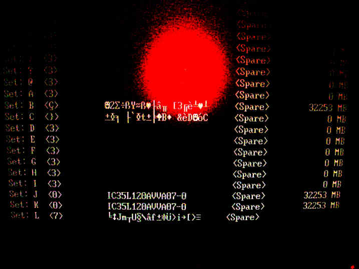

I recently tried two more booting up attempts. Attempt #1 succeeded, with a DOS 6.2 floppy boot disk in the floppy drive. When I was at the A:\ prompt, I typed fdisk, and noted that the HDD had -132 megabytes of storage space, which was a "messed up" value. After quitting fdisk, I could not go to the C:\ prompt, as this gave an error message of "invalid drive" (or words to that effect.)
Attempt #2 gave a strange display, coming from the controller card's BIOS. It is shown in the attached photo below (the red blob is the camera's flash). The information seems all "messed up". Perhaps I need to do one of the following 2 ideas -

The UMC 8881/8886 chipset on your board is said to be PCI 2.1 compliant, but like with all 486 PCI chipsets, you have to take this with a grain of salt. It probably has enough hardware bugs to make many modern cards incompatible .
More like the failure of the 8881/8886 to 100% comply to the PCI 2.1 specifications, but yes, I think the root of the problem is somewhere in that direction.
Maybe you can configure the CSA-649U to work in the board.
My Google-Fu is weak today, did you find anything about the jumper settings?

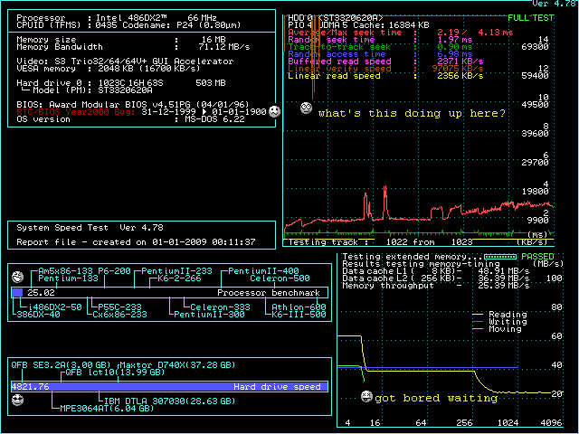

Just for some fun, I ran my first speedsys test on this mobo. I used SeaTools to limit the 320GB HDD's capacity to about 1.5GB, and plugged it directly in to the mobo's onboard IDE controller. I don't know why speedsys reports the capacity as only 503MB though. fdisk seems to think the drive is 1.5GB, so too does the mobo's BIOS.
Edit: I see the "problem". Speedsys seems to think the number of cylinders in the HDD is 1023, but I think it should be 3030. Hence, speedsys seems to think that the HDD is only about one third of its actual capacity.
