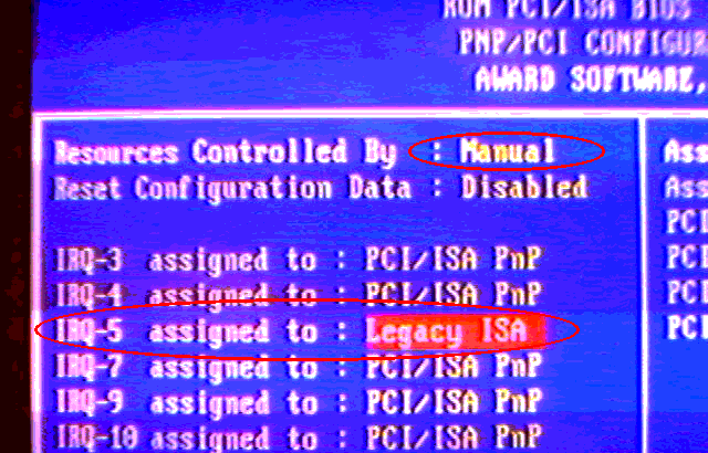

Reply 15 of 28, by tikbalang
turn off "PNP OS" in the bios. and maybe dedicate a specific irq for legacy devices.

Reply 17 of 28, by Moogle!
I've had weird issues over dirty edge conectors. It's just like an old cartridge video game system.
Before switching over to manual resources mode, trip the option to reset CFG data first, if it is there.
Reply 18 of 28, by rick12373
I turned off PNP OS in the BIOS and have dedicated a specific IRQ for legacy devices. I ran Diagnose and set the IRQ to 7. Games will now use IRQ 7 and it seems to be staying set to that. But I am now having a few issues with lock ups in games and a graphical glitches in Shadow Warrior. Also I am running DOS 7 (Windows 98) and I cannot find the MSD.exe file to see if I have any conflicts. How do I check for conflicts?
