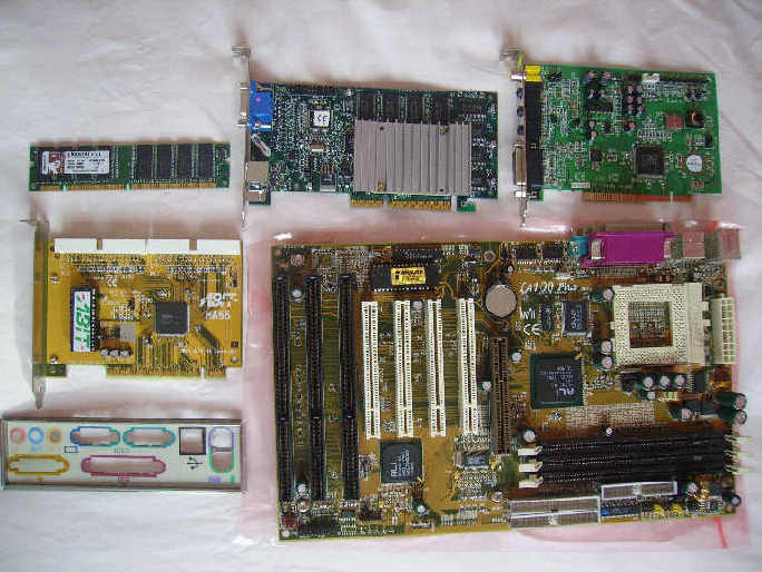

Reply 57 of 237, by retro games 100
I've got some "cheap as chips" bits ready! 😀 They are, from top left, clockwise:
Kingston value ram, PC-100, 256mb
Voodoo3 AGP
Yamaha SP 724 PCI
IWill XA100 Plus
Backplate
Abit 66 speed IDE (Why not? 😉 )
I'm just waiting for a Pentium MMX 233mhz CPU (code SL27S) to arrive. And a cheapo heatsink. Then, I think I'll set it up for Win95.
    77.58 KiB
    1806 views

Reply 59 of 237, by retro games 100
