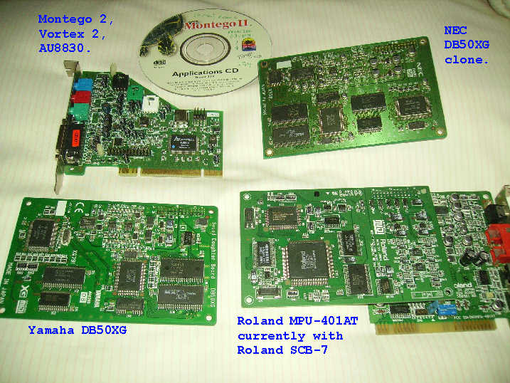

Reply 35 of 44, by retro games 100
Menkau_ra, I've just returned from the attic o' doom, and retrieved some archaic artifacts. I'm about to test them all. Before I do this, can you please tell me what music (game?) you were listening to, so that I can replicate your testing conditions as much as possible. Thanks a lot.
BTW, very unfortunately I only have a pair of $5 crappy headphones. I hope that won't make my tests not worth doing.

Reply 36 of 44, by retro games 100
8 hours later, and about 2 dozen (no really) windows 98 reboots later, and I've got the montego 2 + yamaha db working. About 2.5 hours was spent trying to get the DVD-ROM working on my crusty socket 7 board, in order to install the software. The fix was to delete an intel bus master system device in safe mode, then reboot to allow windows to reinstall it. Finally, it then installed the primary and secondary devices. Beforehand it would just install the parent device, but no primary and secondary devices. Then afterwards, the montego card's mpu-401 device kept vanishing. The fix was to "hard wire" its mpu-401 resource to 300 and not 330. That seems to work. Using the montego's software mixer, I'm confident that when I play a midi music file, I'm hearing the sound coming from the daughterboard, and not the card's own synthesizer. (All channels are muted except for the mpu-401.) I guess I need a good midi file to listen to, to test out the quality of the 2 daughterboards. I thought maybe use one of those old Roland SCC-1 demo tunes, eg demo1. I need a break from this, so I'll run some tests tomorrow. BTW, my logitech headphones aren't that bad, although they were incredibly cheap.
Edit: BTW, using the yamaha DB I couldn't hear any noise or anything "wrong". It sounded OK, no problems. (When I was having install/resource problems, the midi music sounded wrong - missing notes, crackles, generally "odd" sound.) The interesting thing is that windows 98 control panel device section said that nothing was in conflict. (But I guess that windows 98 and the crusty socket 7 mobo weren't communicating 100% with each other.)
Reply 37 of 44, by retro games 100
I've just finished testing the yamaha and clone dbs, on the montego 2 soundcard. Menkau_ra, you said that you "found that daughter board makes a lot of noise". Personally speaking, I can confirm that both these dbs have no "noise" when listening to midi music. They both sound clear. I increased the volume, and my ears hurt but I hear no background noise, or "shhhhhh" sound.
There may be something "wrong" with your mx300 card, either in terms of windows resource handling or a driver related issue or possibly even a hardware defect. Perhaps also investigate your headphones and its audio cable, and any potential interference issues. Also, perhaps retest your headphones using another sound source.
Good luck, I hope you fix this problem.

Reply 39 of 44, by retro games 100
I just tested both DBs on the Roland MPU-401AT card. If I adjust my headphones built-in volume control and set it to maximum, I can hear a small amount of background hiss (when no music is being played). IMHO, it's at a level which is perfectly acceptable. When music starts, I have to turn down the volume anyway, because otherwise it's too loud. At that point, the hiss volume level goes down to a point where I can't really hear it. (It's at a very low level that wouldn't bother me at all.) It's interesting to note that the general overall music quality coming from the Roland MPU card is a bit better than that coming from the Montego. I'm not an audiophile, so I'm probably not very good at describing the differences between the two, but the general quality of the Montego DB sound was "a bit flat and lifeless". OTOH, the general quality of the Roland DB sound was "fairly powerful and lively" but perhaps "a bit too loud and forced". IHMO, it doesn't sound quite as good as a Roland SCC-1 card, but it's not too far off.
