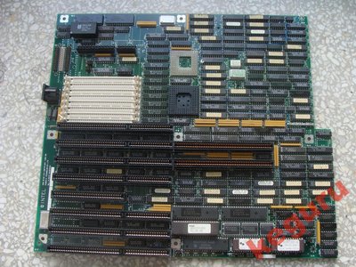

An early Intel iSBC 386AT-25 motherboard (you can add the photo to the first post, although it's watermarked - I doubt the seller will care about it, it's one of these recyclers who trade something they don't know much about):
http://allegro.pl/plyta-intel-z-1985-88-zabyt … 3106256811.html
It's one of the earliest Intel motherboards (there are two older: iSBC 386AT and iSBC 386ATZ). You can find these motherboards in the Intel OEM Boards and Systems Hanbook 1989. It's similar to the Intel System 302 motherboard.

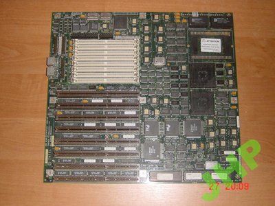

What image hosting service do you recommend? I assume the forum software can't do scaling?
EDIT: now it works.

    Intel 403E

    Intel iSBC 386AT-25
