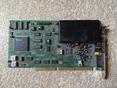

I found this for sale, anyone seen this strange card before? It looks like it got a crystal cs4236 chip and a modem with game/midi port and a wavetable header(?).

There's plenty of info on the IBM mwave, as far as I'm aware it's not a good dos sound card.

It's also not an SB16 clone per se, rather, an SBPro clone, maybe with WSS support, though I don't know which chip introduced that, so take that with a grain of salt. From what I've read around here, it shouldn't be a bad card, at least as far as the chip is concerned. Since it includes a modem, it must be some kind of OEM card, and your mileage may vary.
