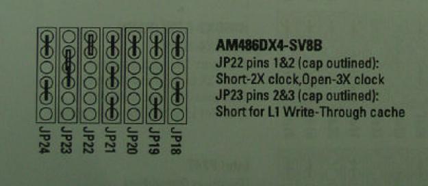

OK, I have an ASUS 486 Socket 3 Motherboard PVI-486SP3 with an AMD 486 DX4 100 that I am using now. I have two 16MB (TMS417400ADJ-60) ram chips to use. I have being going through the manual which I download and have been checking through all of the jumper settings. I am not sure where I should have my level 2 cache size jumpers set to though. Right now they are set to 256kb. Is this right?
Also, I my CPU is the A80486DX4-100SV8B Revision C. I have been looking at the pin diagram for this CPU (see below) but am having trouble understanding it. What does it mean when the rectangular jumper is hollow? If I do this wrong can I damage the CPU?

hollow means there's no connection (no short). The dark line indicates the pins the jumper shorts. So you place the jumper on the pins the dark lines cross. Considering there's no keying on the diagram (it doesn't say where pin 1 is), the jumper labels on the mobo are probably in the same spot as on the diagram.
If you get it wrong it will mostly likely just not power up, not be stable or be slower than it should be.
Reply 88 of 154, by Old Thrashbarg
I think I understood the question differently from swaaye...
If you're talking about the rectangles on JP22 and JP23, it seems to denote optional settings... i.e, the black line on JP23 would be the standard write-back setting, but you could instead put the jumper in the position shown by the hollow rectangle if you wanted to force write-through mode. Likewise on JP22, normally there would be no jumper there, but you could optionally add a jumper at the location of the rectangle in order to force a 2X multiplier. The other settings probably aren't intended for you to screw with, so they're shown as fixed with the black lines.

Well, the jumper setting depends entirely on how much cache you have. I believe most of those boards had 256KB, therefore the current setting is probably the proper one. If you want to be sure, do a Google search for the numbers on the cache chips to [hopefully, if datasheets are still available] find out the capacity.

There can be only 1 orientation. If you switch it around, the jumper numpers are backwards 😉
rick12373, if you were to have trouble finding pin 1, it's usually marked on the motherboard with an arrow or a thicker white stripe (hope that makes sence 🤣)
If you find those marks on the motherboard, you could add that to your manual so you don't have to go through finding pin 1 again next time you have to reset the jumpers 😉
Reply 92 of 154, by rick12373
Yeah, I thought that 256kb cache was right anyway. I know where pin 1 is by the way on the CPU selector and I now have that right as well.
I have just set the CPU External Clock Selector for 33Mhz. And looking through the rest of the manual it looks like I am done with checking jumper settings. Next step is going to be to put the MB in the case.
