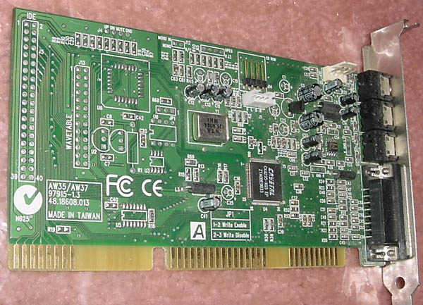

I just bought an Aopen AW35/37 card (the non-pro version without wavetable). Ideally I would have wanted an S23, but I've been looking pretty hard for a few months and came up empty handed, so I finally caved in and bought a Crystal card with integrated clone OPL3. I've heard the comparisons between OPL3 and CQM, and quite honestly I couldn't tell much difference. How does Crystal's version of OPL3 compare to the real deal?
What's interesting, is that the datasheets for the CS4235 and 4237 chip indicate that while they do indeed have integrated FM synthesis, they still have the ability to use an external device. Infact, the cs9233 wavetable chip also has its own integrated FM, so I wonder in a card like the Acer S23A (CS4237B + CS9233) which chip is providing the FM.
It seems CS4232 based cards are much more rare than the other chipsets. I got my S23 from spain, it was the only one I ever saw for sale.
The card gave me a headache because I wanted it to be fully functional in Windows 2000 as well, but the MPU-401 can only be used after initialization in Dos. I wasted quite some time to conclude this. The CS4236B does not have this annoyance.
From what I remember the CS4235/36/37 FM is OK, being on third place of OPL3 clones, after C-Media and ESS. But I need to redo this comparison properly.
I see the AW35 has no wavetable header equipped, does the AW37 have one?
    87.5 KiB
    4161 views
    AOpen AW35 (CS4235)

I haven't quite figured out the difference between AW35 and AW37. Some people say AW35 uses CS4235 and AW37 uses CS4237B. Some people claim it is the other way around. You could be right about the wave table header, but because these cards share the same PCB it's difficult to prove if your theory is correct without some documentation.
I have yet to see a single card with the IDE connector soldered in. If I knew which components to lay down, I wouldn't mind soldering the IDE header onto the card

I got my Acer/Aopen AW37 card in the mail today. It uses the CX4235-XQ3 chip. Unlike the Yamaha, this card was completely painless to install. I think Crystal's version of OPL3 is good enough for my liking as well. I'll probably stick with this card until I can find the S23. At least now I know the crystal chips don't conflict with my hardware.
I wonder if perhaps the EEPROM on the OPL3-SAX card has anything to do with my problems. I was considering to clip it off the card and see what happens. Ideally I'd prefer to just modify the contents of the EEPROM with software, but yamaha didn't provide any software or instructions to do so that I can tell.
