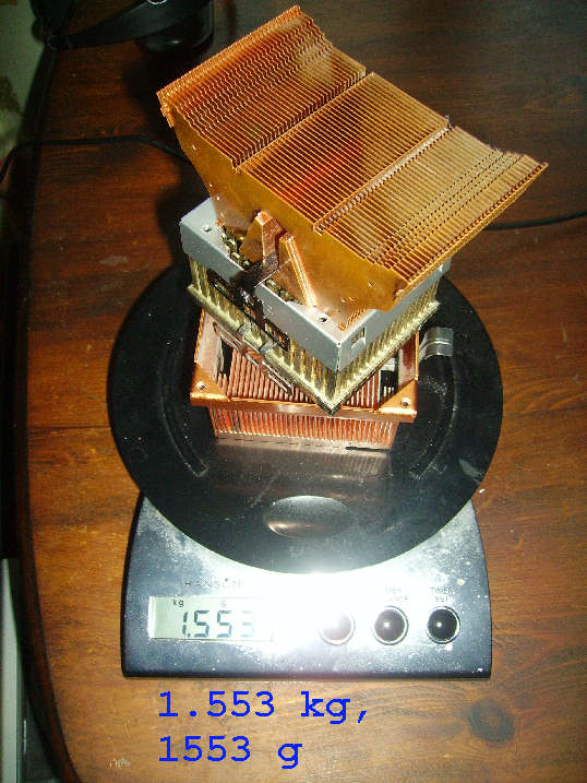

Reply 72 of 85, by retro games 100
5u3 wrote:
Hmmm, sounds like your Athlon CPU's have to suffer a lot... 🙄
Here are three of my "best" Athlon squashers! 😉
    93.83 KiB
    1674 views
Reply 73 of 85, by Old Thrashbarg
Without any kind of thermal paste the heat transfer to the heatsink is very inefficient. If the base of your heatsink is just slightly uneven, this could be almost as bad as mounting no heatsink at all!
This strikes me as a great understatement, so I'll emphasize it. Running an Athlon without thermal paste will kill it. It's not a matter of 'if' but 'when'. If you've been doing it that way, I can only say that you are extremely lucky to any working CPUs left.
Those Athlons put out quite a bit of heat, even the mobile chips are 35+ watts, and moreover they are quite sensitive to heat. Many of the Socket A coolers were barely adequate even with thermal paste.
