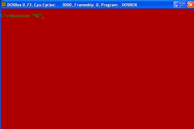

Created a new command for DOSbox.. it's a variant of the command prompt's "Color" command.
Note: Does not support intense colors
Code:
[org 0100h]
[section .text]
mov bl,0x80
mov bx,0x82
mov si,bx
lodsb
cmp al,'"'
jne error
main:
lodsb
shl al,4
mov [digit_tens],al
lodsb
shl al,4
shr al,4
mov [digit_ones],al
xor al,al
mov al,[digit_tens]
add al,[digit_ones]
mov [colors],al
lodsb
cmp al,'"'
jne error
display_color:
mov ah,2
mov dh,0
mov dl,0
int 10h
mov ah,9
mov bl,[colors]
mov cx,16000
mov al,0
int 10h
jmp exit
error:
mov ah,9
mov dx,errmsg
int 21h
exit:
mov ah,4ch
mov al,0
int 21h
[section .data]
digit_tens db 0
digit_ones db 0
Show last 2 lines
colors db 0
errmsg db 'Invalid syntax. Use doscolor "##".', 13, 10, "$"
Screenshots:
I will release the program on request.

Reply 1 of 13, by eL_PuSHeR

Reply 2 of 13, by Malvineous
Does this still work if you do a "dir" or something that causes the screen to scroll? It looks like it just clears the screen with the selected colour rather than changing the current colour.
Reply 3 of 13, by Goalatio
Yeah, i've actually added this to the 16-bit OS that i'm working on.. It keeps the color for 8 pages (Which, is the number that DOS contains in the normal video mode), so, yes, it will keep the color if you do a "Dir" command, or any other command that scrolls the screen.
I'm going to re-write this, because the current version can take anything as the two parameters.. ex;
color aa would output some odd hell-spawned color that I'd never have wanted to see.
Going to change it so it only accepts numbers 1-9. (Just need to port it from my OS.. Which is where I figured out this problem)
It's passion that drives me.
Reply 4 of 13, by Malvineous
But if you're talking hex, colour aa is a valid value. Colour 10 for both text and background. Colour 10 is bright green, so you should have bright green text on a bright green background, or as bg-intensity is disabled by default, blinking bright green text on a dark green background. This is what you would get if you put 0xAA directly into the video memory attribute bytes.
Since there are 16 possible colours for foreground and background, making your program accept a two digit hex number would work quite well.
Perhaps you could make your program fancy by allowing the user to change the bg-intensity bit too, so you could choose between blinking text or bright background colours?
