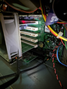

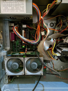

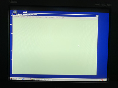

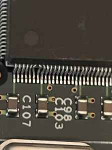

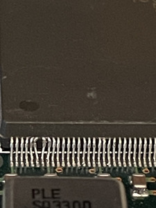

I got it working again this morning but eventually you’ll see this.
Attached a couple pics of current state of pins. With the way a few of the pins are smashed in I don’t see a way to improve this much more on my own.

We’ll shoot guys, sometimes you forget the basics, I cleaned the pins in the pci edge and now I’m running PureVex atm.

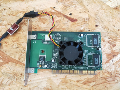

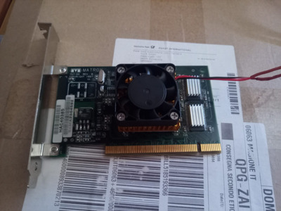

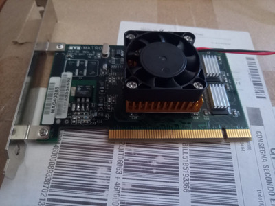

Hello everyone, let me introduce myself. I'm Italian, and I'm a big enthusiast of graphics cards and processors. I've been a nerd for about thirty years or so. 😄 The PCX2 was my first 3D graphics card, and thanks to this forum, after 25 years, I managed to replace the crystal and restore it to its former glory. I've read the entire thread, and I really hope that someone willing and capable can program a new SGL to OpenGL driver. This card deserves so much more, and now that the source code has been released, I genuinely hope that something can happen. I'm attaching a picture of my modified and overclocked M3D. Oh, and this is my YouTube channel. Whenever I have time, I always share something interesting for fellow old-school nerds: https://www.youtube.com/@JackJungle/videos

Mine is working with a 20MHz crystal, so I believe the correct calculation is 20 * 3.7 = 74MHz. 😀
I just tried it with a 24MHz crystal, but it's a no-go. Considering that it has been dead for 25 years, it is still a tremendous achievement. 😀
