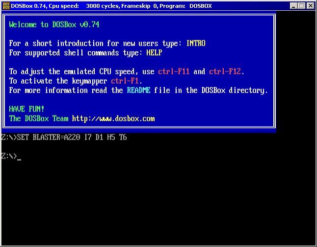

Aspect correction in text modes not work (setting "aspect=true" do nothing). There are textmode games, so it's important.

Most normal text modes are forced to 1:1 aspect ratio. I think that was done because the blending of pixel rows that occurs with aspect correction can look rather ugly in windowed mode unless you're scaling up (e.g. "scaler=normal2x forced"), although in fullscreen you typically would be scaling up. At any rate, it's easy to remove the 1:1 aspect override for text modes in the source, if you're up to making your own build.

I wouldn't call something done intentionally an "issue"; more a matter of personal taste.
Just to help visualize why text is forced to 1:1 aspect, a couple of screen shots with 4:3 aspect that show the distortion and blurring that can occur:

Normal VGA text mode is equivalent to 640x400 pixels, so if you compare that to a game using 640x400 graphics, yes, the effect is about the same. But a 320x200 graphics game with a normal2x scaler has doubled pixels, and I think the aspect correction looks just fine on that, even in a window.
Not all text modes have a 1.2 pixel aspect ratio; e.g. machine=vgaonly has VGA text of 720x400, which would need a pixel aspect ratio of 1.35 to create 4:3 aspect (720x540). So there are some considerations in calculating the correct aspect for text.
Something like "aspect=true forced" could be used to disable the 1:1 aspect override on text, but not sure if the devs could be sold on the idea.
