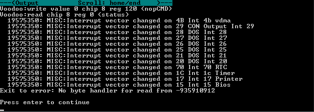

A question for the experts: while debugging the dll functions from msvc inside dosbox, sometimes an access to the voodoo memory generates an error in dosbox, which blames for missing byte handler in reading/writing memory; that should never happen since byte access is not supported. This actually does not happen when launching a game directly (no debug). Any clue?

Reply 25 of 386, by wd
Rank DOSBox Author
DOSBox Author
What do you mean "byte access is not supported"? Since your handler is derived
from PageHandler any non-dword (or maybe unaligned) access may trigger a
byte access, or am i missing something?
Easiest thing to do anyways is to put a breakpoint onto that function and check
the call stack when it's it (game under visual studio in dosbox under visual studio,
that should work!!!).
Reply 26 of 386, by kekko
according to the documentation:
9.2 Memory Accesses All Memory accesses to SST-1 registers must be 32-bit word accesses only. Linear frame buffer accesses ma […]
9.2 Memory Accesses
All Memory accesses to SST-1 registers must be 32-bit word accesses only. Linear frame buffer accesses may be
32-bit or 16-bit accesses, depending upon the linear frame buffer access format specified in lfbMode. Texture
memory accesses must be 32-bit word accesses. Byte(8-bit) accesses are not allowed to SST-1 register, linear frame
buffer, or texture memory space.
it happens during register read, which should be always a 32-bit access.
Putting a bp in a game under visual studio in dosbox under visual studio (quite confusing isn't it?) just shows few mem calls starting from dyn code up to readb handler; what should I look for?
Is there a way to force aligned memory access for my page handler?
Reply 29 of 386, by wd
Rank DOSBox Author
DOSBox Author
Other way round: in the visual studio that debugs dosbox (outermost level)
put a breakpoint at the readb function that has the E_Exit() in it.
I don't know why there would be a difference if the game is run under a debugger,
but maybe they are intercepting some page accesses (initialization etc.)
which would produce this error if they tried to "emulate" the access. This would
mean that the game (voodoo part) may or may not work when the debugger
is attached to the game.
In general of course you can access the address-space as you like, question is
what the voodoo hardware/memory controller does (as hal says it may even have
some deterministic effect), so just add the respective handlers+logging.
Reply 30 of 386, by kekko
here's the call stack.
I added empty readb/writeb methods, it does not crash, as expected, plus it seems it keeps reading and writing to registers correctly...
    40.36 KiB
    487 downloads
Reply 34 of 386, by wd
Rank DOSBox Author
DOSBox Author
If so then that visual studio+game thing would not work on real hardware.
Any way, most likely it's something simple as visual studio checking what
type of memory there is (i'm getting a dword access to a page i don't know,
let's see (==byte read) if it's a rom page).
