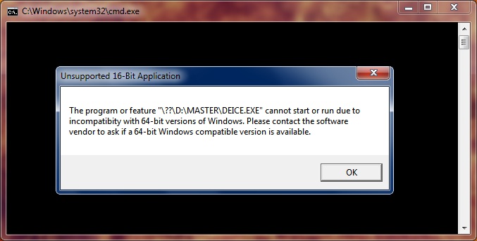

2 more questions:
1. How go I get the Master & Maximum Levels installed? I was given errors when I tried (attached).
2. Is there a way to install just Ultimate Doom but have the levels from II & Final be choices when playing?

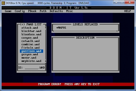

Reply 9 of 17, by Corey
😕 I don't know what I am doing wrong.
Using DosBox, both Maximum & Master have been installed; but I can't get either to play.
1. Open Dosbox
2. Mount C C:\games\Doom\Master (or Maximum)
3. Change to C:\
4. DMLoad
5. Choose Doom 1
6. Choose a .wad
That's when I get: "PROGRAM ERROR! PRESS ANY KEY TO EXIT"
Same error even if I use both:
Mount D D:\ -t cdrom
I also copied all the .wad files from the Master dir. into the ZDoom dir., but when I start ZDoom, none of those .wad's are found. How do I use the Master & Maximum Levels?

Reply 10 of 17, by eL_PuSHeR
Try using
Mount C C:\games
c:
cd doom\master (or whatever inside DOOM subfolder)

Reply 11 of 17, by SKARDAVNELNATE
I'm guessing that's where it installed to. Meaning Doom and Doom 2 would be higher up and Doomit won't be able to reach them.
I use MOUNT C C:\DOS\GAMES\DOOM
within that folder I have DOOM, DOOM2, TNT, PLUTONIA, and MASTER
While running Master Levels I set the paths for Doom and Doom 2 as C:\DOOM and C:\DOOM2

Reply 14 of 17, by SKARDAVNELNATE
So by using C:\games\Doom\Master as the root of C:\ you don't have access to Ultimate or II. Which it needs.
Use C:\games\Doom as the root of C:\ then change directory to the one you want to launch.
MOUNT C C:\games\Doom
C:
CD Master
DMLoad
Reply 15 of 17, by Corey
SKARDAVNELNATE: I did exactly as you stated>
1. Opened DosBox
2. Typed Mount c c:\games\games
3. C:
4. CD Master
5. DMLoad
Menu comes up & I can select Doom 1/Doom 2
After, another menu w/the Wads comes up; I scroll to any & press Enter.
Same error message: "PROGRAM ERROR! PRESS ANY KEY TO EXIT"
This is confusing. Why won't these Wads from Master show up when using ZDoom? Be much easier.

Reply 16 of 17, by SKARDAVNELNATE
In Doomit theres a menu at the top. One of those sets the path. Make sure the Doom, Doom 2, and wad paths are correct. For the wads I have it set to C. It then looks for them in C:\MASTER\WADS. I haven't been able to reproduce that me error so I'm guessing at the cause.
I'm more familiar with DoomsDay than with ZDoom. Does it have an addon manager or a folder to move addons to?
