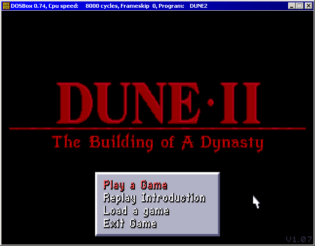

Same as other shot, only with output=opengl. See any difference? There actually is a little bit, if you do a "difference" of the two images in Paint Shop, you'll see small differences in the blending.
If you don't see the vertical blending of pixels going on in these shots, you need to look closer, or blow them up with a viewer.

Can't see a difference in your shots at all...
You didn't go fullscreen yet, did you?

The point I made was not about what output looks more blurry than another. I said that blending of pixels will occur with aspect correction unless you use output=openglnb. Look at both of my shots, they both show the pixel blending.

And your screenshots are poor examples. Look at clean text on a plain background like the menu in my shots, the blending is very easy to see.

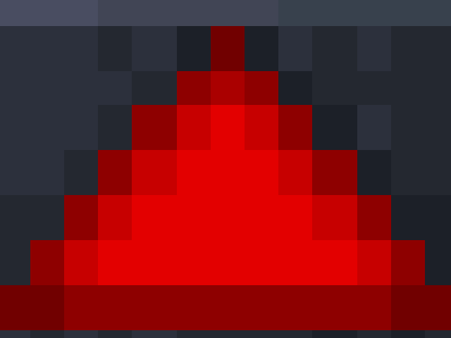

Fullscreen mode does blow them up, though. How else do you think a 320x200 image scaled to 640x400 with a normal2x scaler becomes as large as your display?
Here is a part of your ddraw screenshot blown up in Paint Shop to 16x. You can clearly see that the pixel blocks are of irregular height. If you really are using ddraw, then your ddraw behaves like openglnb at higher resolutions. Because when I use ddraw at fullscreen, I still get filtered edges; but the edges are so small that it's harder to notice the filtering.

Yea that shot was with ddraw.
There might be other factors we arent aware off. I'm using ATI onboard graphics and W7, so there might be differences depending on what hardware and software one uses.

I know there are distinct differences due to graphics drivers, that is nothing new. First time I've heard of a case where ddraw behaves like openglnb in fullscreen, though. Maybe we can conduct a poll to see which is the more common behavior (blocky or filtered in fullscreen ) amongst other users of DOSBox. 😉
