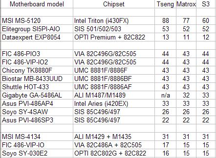

The following table shows the maximum bus transfer rates (MB/s) of different boards/cards combinations. The graphics cards Hercules Dynamite 128 (Tseng ET6000), Matrox Millennium (MGA2064) and Elsa Winner 1000 (S3 Trio64V+) were used.
They were first tested on a Pentium mainboard (MS-5120) to determine the card's max. data transfer rates when no bus limitations are present. You can see that in this case the rate is limited by the cards and not by the bus.
All other cases show that the transfer rates are not limited by the cards but only by the bus.
Hmm, i don't know why the SIS is so slow and I don't see any "suckage" with the UMC Chipsets 😒
retro games 100 wrote:
Generally speaking, is a socket 3 PCI board perfectly satisfactory, or would you consider a decent VLB/ISA board to be superior to all PCI boards?
Regarding the results, I would say that the PCI bus yields no significant higher transfer rates on 486 systems compared to VLB designs.
Every VLB board should be capable of transferring >35 MB/s over the bus, even more when clocked higher than 33 MHz.
The major benefit of having PCI is the higher flexibility because of the huge assortment of card alternatives.
-only an opinion-

@bastlermike
Did you use 3dbenchmark for your test? I believe it mostly stresses the CPU

I don't remember the name of the tool, i was something with "transfer..." or something 😕
These measurements are only bus- not CPU-dependent. In all cases the bus frequency was 33 MHz. The tools writes data to the video memory and so determines the maximum bus transfer rates. Tests were executed with DX2/66 or Am5x86- 133 (P5-66 and P55C-166 on the Pentium boards).
