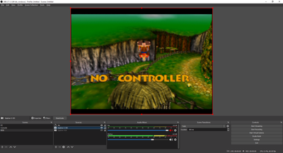

Reply 1147 of 1403, by TehGuy
Pleasantly surprised to find out that, with the S-Video A/V addon, the DVI2PCIe can handle composite signals just fine. My N64 and GC have zero issues displaying over that, and my Dreamcast was fine via VGA to DVI cable; none of those seem to have any delay between controller input and what I see in the OBS preview. The smallest overall image it'll give OBS is 640x480, but it looks like it'll accept resolutions smaller than that and just put borders where it needs to; N64 seems to be letterboxed, my GameCube is just bordered on all sides but that might be on a per-game basis, still gives me hope that something like 320x200 is going to work just fine. Device figures everything out without any fiddling unlike the Intensity Pro I got earlier, at least any further fiddling than shifting the video horizontally or vertically (needed a horz shift on that N64 capture).
Still need to test with DOS as the config software says it'll support strange things like 720x400@85 with an option to add custom resolutions/timings (which might solve the border problem if I can get them right), but I'm too lazy to unplug the beast and haul it over and mess with all that until tomorrow
690.45 KiB
1942 views
My man Banjo on real hardware

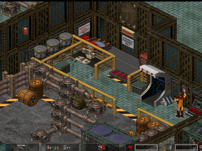

Reply 1148 of 1403, by imi
question for anyone capturing with a datapath card, I've recently encountered an issue and so far haven't found a solution...
some SVGA resolutions seem to be "shifted downwards", so a few rows of pixels missing off the bottom and a narrow black bar on top, in 640x480 it's 5 pixels and in 800x600 it's just one pixel
sometimes it won't even let me shift the picture up enough to reveal the missing area, but if it does there is actually still no capture there, it just duplicates whatever the bottom pixel row was at the moment, if I try to increase the vertical capture resolution it just artifacts below i.e. 480 pixels so wherever in the chain those pixels just get "lost".
I hadn't really noticed that until now cause I was doing mainly DOS and VGA games at 13h and never encountered something like that, only recently when I played Descent 2 I noticed that but attributed it to the game at the time... but now I tried Crusader: No Remorse and got exactly the same issue, same thing in Duke3D and even in Windows.
591.04 KiB
1876 views
I tried eliminating variables today, I tried 3 different GPUs, RIVA 128, TGUI9680 and a Matrox Millenium with the latter clearly having the nicest picture ^^ but while I had to adjust settings between all of them for a pixel perfect capture all of them exhibited exactly the same behaviour at those higher resoutions.
tried both channels on my VisionRGB E2S, tried with and without VGA switch, nothing really made a difference.
it's the same in VCS and OBS via RGBeasy or just normal capture, I just can't get those bottom pixels to get captured.
Anyone ever encountered this and knows a solution?

Reply 1151 of 1403, by imi
I'm trying to capture under DOS, Crusader for example doesn't even run in windows, I can try powerstrip though.
