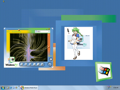

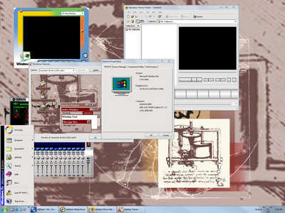

this is a screenshot of windows millennium with start orb and things i used 98lite and revolutions pack. Used Millennium STEPUP edition on a fully patched 98SE system.
    1.99 MiB
    332.49 KiB

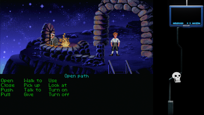

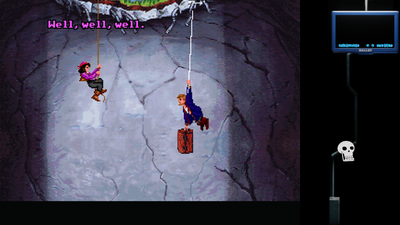

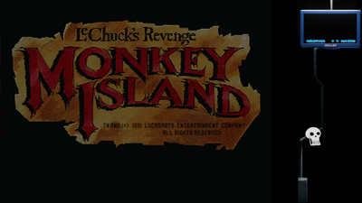

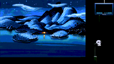

After getting all the pieces together i was able to create the cheap capture setup i had in mind, i'm using a VGA2SCART ---> GBS control ----> vga to hdmi converter to get these results, i blame the cheap capture card for most of the blurriness but all in all it seems decent.
https://streamable.com/lenc26
https://streamable.com/yjp6dt
EDIT:Finally ludicrously sharp DOS capturing
EDIT2: I remember reading that jazz jackrabbit wouldn't scroll correctly on a matrox card (i think this information is still in the wiki) but it works perfectly on my G200
https://streamable.com/sptfnr
I had to lower my CPU speed with setmul but that means that the problem is related to the CPU's speed and not the GPU
