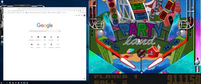

use the capture card as a monitor (old pc -> capture card -> uw monitor) - it is possible to sync to the old pc refresh rate with gsync. the scroll is super smooth (like on a crt).
