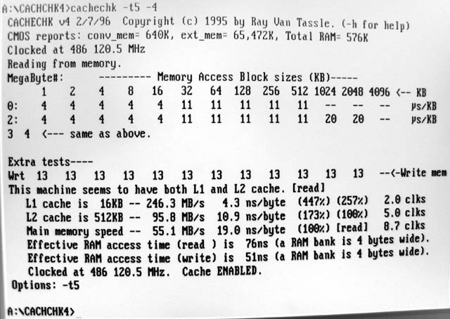

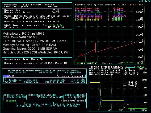

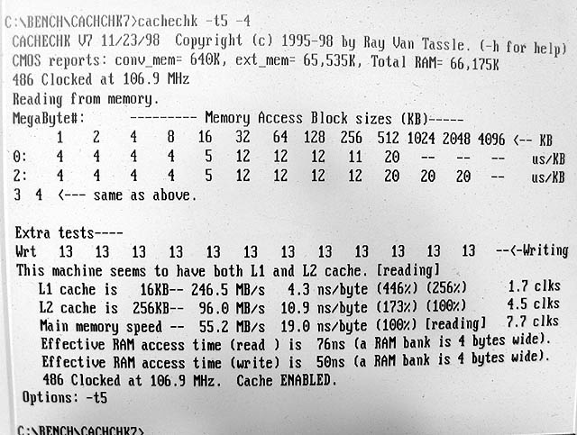

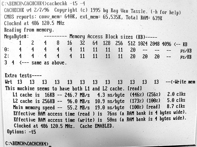

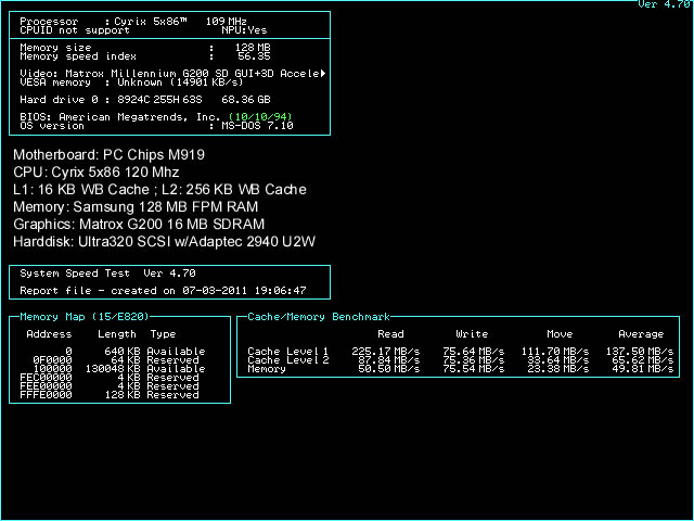

I have attached some screen shots of SpeedSys and Cachechk.
[NOTE: filenames of the first and second cachechk image are slipped. I can't seem to correct it -- perhaps some bug with this forum's software.]
The measured cpu clock speed from Cachechk 4 does not agree well with that of Cachechk 7. Cachechk 4 reports the correct speed at ~120 Mhz, whereas Cachechk 7 reports it as ~107 Mhz. Both agree well on the L1/L2/RAM speeds though. Has anyone else noted this with Cyrix cpus?
SpeedSys reports the cpu speed at 109 Mhz. I suspect the speed discrepancies are due to some kind of software timing algorithm used to measure the speed. I've run a dozen bench utilities, some say 89 Mhz, some say 120 Mhz, 107 Mhz, 109 Mhz. This occurrence is not isolated to this particular motherboard/cpu combination. Identical hardware on my Biostar MB-8433UUD ver. 3 shows similar cpu clock reporting conflicts. Nonetheless, the data from the actual tests is what is important.
For the poster of the AMD 200 Mhz cpu, could you also include the sub-screen on the memory speed tests, its option M on SpeedSys. I would be very interested if you can stably run Windows NT 4.0 on that system.
I get a 3dBench score of 76.9 frames/second. I am not sure if this is good or bad. I do not play games.

feipoa, thanks a lot for posting all of this info! 😀 For comparative information, I posted my test results for the Biostar MB-8433UUD on this Vogons thread here. If you scroll down that page to my second post which begins "I have just returned to this Biostar mobo".
I didn't know about the "M memory" option for Speedsys, however luckily you can get an idea of these values by looking at the Speedsys graph on that webpage. The memory values seen in the "M memory" section are values taken from this graph. They are taken from the graphical lines on the Speedsys screenshot before they "dip downwards" for the very first time. Also found on this post is a Cachechk(7) .txt attachment, and I also mention my 3DBench (1.0c) score, and a few other bits of info.

Reply 107 of 148, by udam_u
Thank you for your results! Now everything is clear.
You are right, my cx5x86@120 was also recognized as 109MHz and 5x86@150MHz as 136MHz. [:

My 3Dbench results aren't spectacular because I am using a 1:2/3 Host-to-PCI clock divider in the BIOS for enhanced system stability in WinNT4. When it is set at 1:1, I get a 3Dbench score of 91. Also, a Matrox G200 graphics card isn't the best 3D performer; it is know for its 2D capabilities (all I use it for).
As for the speed results of Cachechk7 and perhaps Speedsys, it might be also due to the PCI clock divider and how these programs measure the frequency. For example, 2/3 * 40 Mhz * 4 = 106.8 Mhz. This is what Cachechk7 reports. I'm not sure why it multiplied it by 4 though.
I get a similar 3Dbench score of 71.4 fps on the M919 with identical hardware, however this bios doesn't have a PCI clock divider, which is curious. You'd think it would be 91 fps, unless the BIOS is doing some auto division without me knowing it.

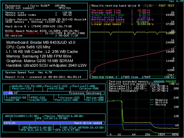

Reply 109 of 148, by feipoa
I ran Speedsys on my Biostar MB-8433UUD v3.0 as well. It performed much better than the PCchips M919. All memory results now outperform the AMD at 200 Mhz with a stock Cyrix 5x86 - 120 Mhz and a Matrox G200. Here is a summary of all tests I have run:
Speedsys:
Benchmark number: 65.49
L1: 172.98 MB/s
L2: 67.92 MB/s
Memory throughput: 47.97 MB/s
L1 Read: 224.66 MB/s
L1 Write: 75.49 MB/s
L1 Move: 218.80 MB/s
L1 Average: 172.98 MB/s
L2 Read: 87.66 MB/s
L2 Write: 75.21 MB/s
L2 Move: 40.89 MB/s
L2 Average: 67.92 MB/s
RAM Read: 50.44 MB/s
RAM Write: 75.48 MB/s
RAM Move: 18.01 MB/s
RAM Average: 47.98 MB/s
PcpBench: 8.8 [EDIT: 9.7 when using Diamond VLB and M919]
3DBench (1.0): 90.9
CTCM7: 32MByte, Cache Area (should go to 64Mbyte when I put 512KB back in, or 128Mbyte in Write-Thru mode)
MAXUM Processor clock speed test shuffles between 121 Mhz and 104 Mhz
Cachechk v4
L1: 246.3 MB/s
L2: 95.8 MB/s
RAM: 55.1 MB/s
RAM access, read: 76 ns
RAM access, write: 51 ns
120.5 Mhz

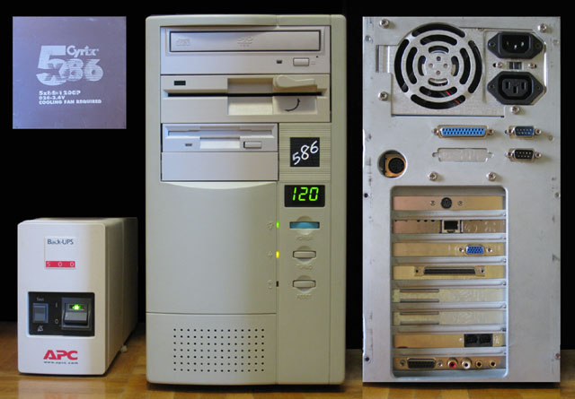

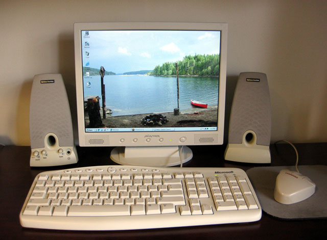

Thought I'd post the face to those specs.
