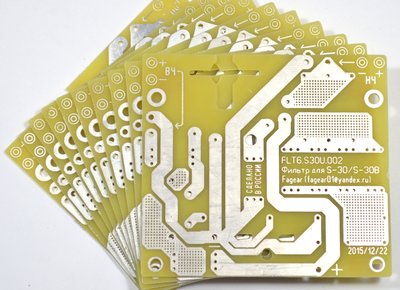

j^aws wrote:
Nice choice of colour, Fagear; they look like special editions.
Well... It's just the color of bare PCB. 🤣
j^aws wrote:
If there are spares going, I'd love to order those brackets as well
amigo-mexicano wrote:
Any info on the brackets, ready for sale Fagear? 😀 We are anxious...

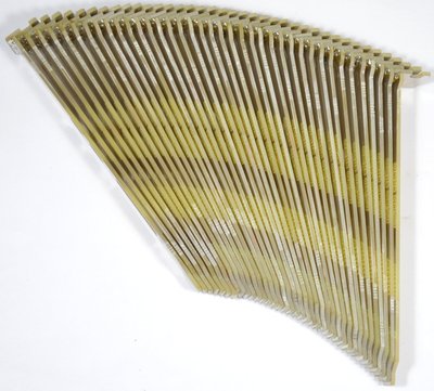

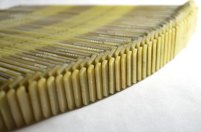

Yep!
Got today another batch of PCBs for my projects and here they are:
617.38 KiB
1920 views
430.95 KiB
1920 views
367.28 KiB
1920 views
38 of them.
And some boards for another project (crossover for USSR speakers):
528.38 KiB
1920 views
And I will soon get factory-made ones for those speakers. I'm going to sell those crossover boards and then I should be able to launch new batch of SSI-2001 replicas. 😀
New BIG soundcard: FMonster.
Covox Sound Master replica
Innovation SSI-2001 replica & DuoSID.
My audio/video collection.
