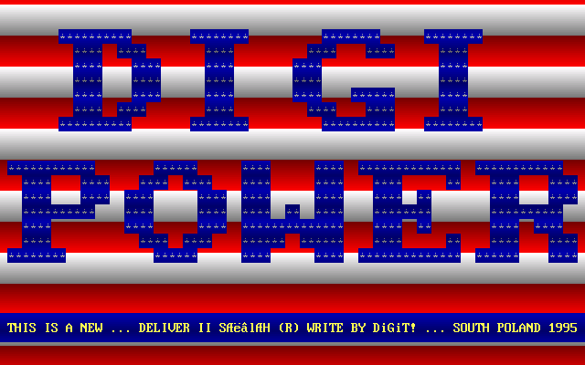

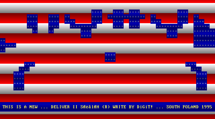

However, there's one virus in the program's lexicon called `Deliver Stealth` and it demonstrates some kind of animation. Unfortunatelly it is glitchy in dosbox - looks like that:
But it should be:
Can any of dosbox's expert express their opinion?
This program definitely uses come non-conventional DOS methods for screen displaying.
(The background is filled with animating bars - they're changing colour from red to gray) However, in dosbox it is rather the whole background in one solid colours than bars and the big `DIGI POWER` text is glitched.

The "DIGI POWER" part is rendered correctly when loading a video bios in DOSBox. The difference appears to be that INT 43h is pointing at the 8x8 font in mode 3 in real video bioses, but DOSBox's emulated video bios has it pointing at the 8x16 font. The RBIL does seem to suggest that DOSBox has it right, but it's not super clear, and the real bioses are evidence to the contrary. At any rate, it works correctly when DOSBox is modified to point the vector at its 8x8 font.
The color banding appears to be changing the palette in sync with video timing (horizontal retrace) such that bands appear. Not sure if DOSBox can handle that kind of thing. I know hal had to do some work to implement similar behavior for Jungle Hunt and Frogger in CGA.

the background scrolling bars effect works on SVN builds like MB6 / ykhwong's, if you set the config option linewise=true.
the text is still broken, however - screenshot attached...

Yeah, 8x16 font data doesn't work too well when it's expecting 8x8 font data. The attached program changes INT 43h to what the program expects, if you really want to see it.

Oops, didn't notice your previous post before posting mine... I should've recognized those sliced-up 8x16 chars. 😀
confirmed - the TSR works fine.
