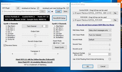

Falcosoft wrote:
The 2 functions give different results regarding volume level. The floating point one results in twice the volume.
Whereas I completely agree with the Facts, I'm not sure if this statement is true. This is so relative. It may look straightforward to deal with the signal volume in the 16-bit integer format but float samples are NOT native for the original hardware units. Even with integer samples there are quite interesting things to consider.
Indeed, we took quite some time to ensure the correct output volume when it comes to integer samples. It closely corresponds to what we get using the digital sampling right at the DAC entrance when the analogue output emulation is turned off. You may consider the volume to be nearly bit-accurate. On the other hand, analogue output emulation does make the output signal volume differ (depending on the frequency), so even with integer samples there is not much to compare with. And I even don't mention that virtually every analogue capture taken from a real device may have arbitrary volume 😀
OK, speaking of this particular question, it depends on how you measure the volume of float samples. The mt32emu routine that does the sample format conversion actually divides an integer sample by 16384 to produce a float one, and correspondingly a float sample is multiplied by 16384 to return an integer sample. This is mainly intended to adapt to the common rule of having float samples normalised. So, if you say you get the output volume doubled, then it seems your audio processing path expects a different multiplier, i.e. 32768.
However, all is not that simple. Real units are famous of suffering from digital overflows. When we started the float rendering engine, the main goal was to get rid of that sort of things completely. So, the output signal you get with float samples is not actually normalised. It may exceed unity in absolute value, so you have a possibility to normalise the whole recording further.
Another thing to consider is the output from mt32emu is usually too low compared with SFX in most games. So, making it reliably never-ever overdriven is not an option as it'll be difficult to mix nicely. That is why we don't map float 1.0 to integer 32768. Actually, the float renderer internally maps unity to 8192 in the integer renderer. This is the natural full volume of a single playing partial in the engine. It leaves some room for mixing more partials though, but as I said, it's easy to overdrive. The multiplier 16384 used in the sample format converter just takes into account the DAC bit shift that real units feature.
In the conclusion, I'd want to note that it's quite easy to change the output volume with almost no effect on the emulation. Use functions mt32emu_set_output_gain and mt32emu_set_reverb_output_gain for this. By default, the gain is set to 1.0, so supplying a value of 0.5 makes the output twice lower.
PS: Though, I also agree that now, when mt32emu has two rendering engines side-by-side and provides sample format conversion in-flight, this stuff is rather confusing. I'll consider making the volume of float renderer such as to have smoother float <-> integer conversion.
The plugin has the corresponding controls (gain/reverb gain) and the user can set them freely.
126.83 KiB
1365 views
The problem is the users compared the default output (samples get with mt32emu_render_float
+ 1.0 gain + default DAC input mode 'Nice') to the Windows driver that produces half the volume level with the default setup. Actually I do not have any problem with the current implementation, and I recommended the users to change the DAC input mode to 'Pure' if the higher deafult volume is problematic for them. Why 'Pure' mode is not selectable in the Qt client anyway?
Thanks again for your help.
OK, that's nice.
Hmm, but it feels like I now have one 😀 After more thinking about it I became to a conclusion that the current behaviour is actually a mess. Regardless of whether the output float signal may overshoot, it must be (almost) normalised, so your users have a rationale.

It would be advantageous if you could add something like this to the C API:
mt32emu_bit32u mt32emu_get_rendered_sample_count(mt32emu_context context) {
return context->synth->renderedSampleCount;
The reasons are here:
To sum it up In the VSTi plugin sample rate can change at runtime and Munt's timestamp is important because of VST event blocks that can contain offsets.
So I always try to figure out what the actual inner timestamp of Munt can be by calculations that can produce rounding errors (especially at sample rates like 44100) to use the ***_at functions.
I do not care my sample rate dependent timestamp only Munt's is important. But currently it's a black box. All the error prone calculations could be avoided if the C/C++ interface would make this value public.
Also in the documentation maybe the 'synth' should be changed to 'context' since first I thought that an mt32emu_close_synth() and mt32emu_open_synth() sequence resets the timestamp, but actually only new contexts reset it.
timestamp is measured as the global rendered sample count since the synth was created (at the native sample rate 32000 Hz).
Thanks in advance.
Ps: I know about the conversion functions mt32emu_convert_synth_to_output_timestamp() and mt32emu_convert_output_to_synth_timestamp() but they do not help without knowing what the synth's internal timestamp exactly is. (I could do the calculations exactly like these functions do in my code) .

Reply 848 of 965, by Falcosoft
Hi,
I have seen you have also made modifications to cure the mt32emu_render_float() related volume/normalization problem.
I compiled the new version and the default is now perfect .Mt32emu_render_float() volume level is now the same as mt32emu_render_bit16s() and so the Windows driver. Now at 100% gain, the level is half of the previous version. So in order to get the same volume level you have to duplicate the gain now.
But the problem is that when the internal floating point rendering is NOT enabled the new version is much more distorted at higher gains than the previous one.
I have made a video about the issue. To make things more clear I have given the new library the version number 2.1.1 (vs. the old 2.1.0)
The video:
https://youtu.be/hZ1FBoXNovY
Ps:
in the new version of the plugin the Gain slider range is 0 - 400% (0 - 4.0f). In the old version the Gain slider range was 0 - 200% (0 - 2.0f).
I forgot to mention but mt32emu_get_internal_rendered_sample_count() works perfectly 😀
Thanks for your efforts.
Edit: Forget it, I have just checked and the old version of the library produces the same level of distortion if you use 4.0f Gain and multiply the sample results given back by mt32emu_render_float() with 0.5f (to get the same volume level as the new version). So it could only be a drawback for users who actually liked the higher volume level and they cannot compensate the current lower level with doubled Output Gain of Munt. But they can use a regular Gain VST effect plugin if they want pure doubled volume.
Website, Facebook, Youtube
VST Midi Driver Midi Mapper
Reply 849 of 965, by sergm
Oh, just wanted to point out that one should actually expect distortions when setting the gain above 1.0 (at least with integers). This facility only exists because of some games programming the master volume too low, so you can easily regain the balance this way.
