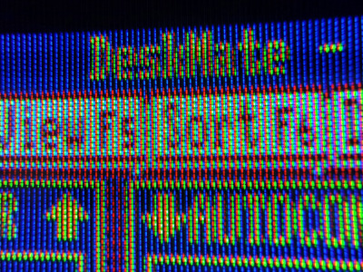

Edit: I used a different camera and was able to take a picture of the vertical r/g/b lines. The colours in that picture are off, but that's a camera issue:
560.75 KiB
864 views
Vertical phosphor lines

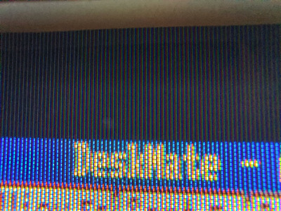

I've added another picture that has more accurate colours but no vertical lines:
714.05 KiB
864 views
More accurate colours
My CM-5 is even worse than I remembered. I counted only 19 phosphor groups per cm in horizontal and vertical direction, so that's about 0.52 mm dot pitch.

All great observations and suggestions! Thank you.
The flat part bothers me the most because at the moment I cannot use curvature or there will be severe artifacting of the image. I need a higher end monitor to get more resolution for this. I'd love to improve here.
The phosphors distinct on the CM-5. Mine has vertical grey lines that are definitely visible when off, and midly so when on. That will be more difficult to produce.
Thanks for the photos, they are excellent and very helpful. 😀

On my picture the r/g/b line colours are visible, but they look grey to me with the naked eye.
