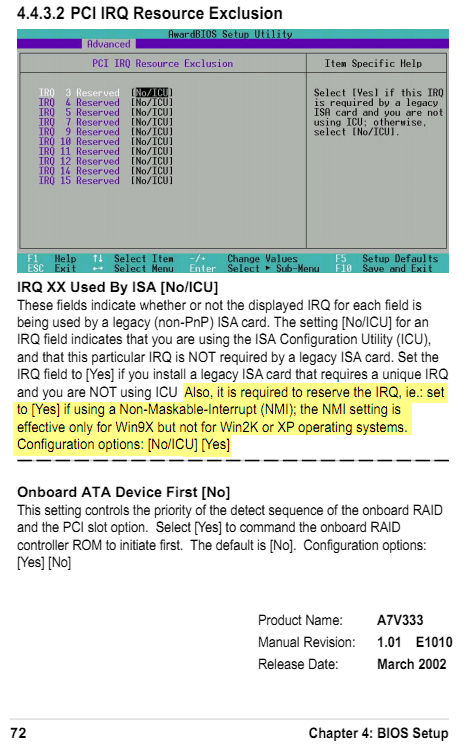

Reply 21 of 26, by fdlchris
gerwin wrote:
In the KT600 BIOS manual it mentions support for Non Maskable interrupts (NMI's) was dropped on the KT600.
@gerwin - As the BIOS is probably the same, or similar, where would I find this setting? Can you instruct me where to go to find this option, and what do I need to set it to?

Reply 23 of 26, by gerwin
fdlchris wrote:
I found it again, what I meant is that the yellow text is present in the Asus A7V333 mainboard manual. The Asus A7V600 has the same text, except that the yellow text is missing there, thus I think they dropped the NMI function on the A7V600. While it is a required function for most Soundblaster emulation methods.

Reply 24 of 26, by fdlchris
gerwin wrote:
fdlchris wrote:
Probably because they anticipate users moving forward onto newers OSes such as 2k and XP. They didn't expect anyone to be still using Win9x.
