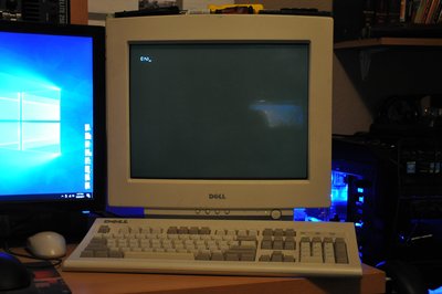

I've been sandbagging off this website for a while now and finally decided to join. Here's my W98/DOS rig: Pentium MMX 200MHz, 128MB PC66, Matrox Millennium II, SB VIBRA 16 and Roland SC-55.

Welcome aboard! 😁
Is that a good place to store floppies? I try to always store them on places where there are no electronics in the most direct vicinity (even though I don't even know for sure if this helps in all cases).
Chances are your board only caches up to 64MB (but I suppose you're already aware of this?), unless you're using a (Super Socket 7) board which can cache more. You're perhaps running a TX board?
edit: Well, I decided to just go look it up. According to the always-right wiki your board uses a 430VX chipsetted board (unless of course somehow the original motherboard got switched with something else). How did you crap 128MB of SDRAM into it? I've understood that people who try to put a 64MB DIMM into a VX chipsetted board, they'd only "see" 16MB instead of 64MB.
I'm not a fan of Dell machines, never was really, but your case looks neat and it appears as if it is new. Nice!
How are you using your floppy drives and ZIP drive?

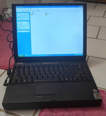

Here are two;
For MS Paint animations/images-
1.59 MiB
914 views
Pentium ii 400Mhz
64MB DDR RAM
2MB 3D capable iGPU
10GB HDD

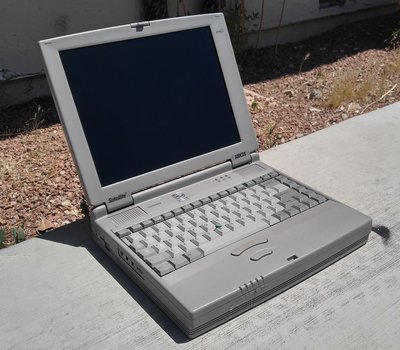

Needs a hard drive.....and a screen-
2.03 MiB
914 views
233Mhz Pentium MMX
32MB RAM
1MB iGPU

The board is stock, it will support 128MB of RAM (unofficially), but it's VERY picky about what will work. That's probably why a lot of people say it won't, because they tried it but they didn't use the right stuff. You have to use double sided 16 module DIMMs, and even then not all of them will work. The only ones I got to work were a set of NEC PC133U DIMMs, which were actually 256MB a piece but were recognized as 64MB a piece by both the BIOS and Windows 98. I also tried a set of Micron double sided 128MB 16M DIMMs but they were only recognized as 32MB each, so I'm not exactly sure what the parameters are for getting 128MB to be recognized. Anyways, Windows 98 runs noticeably quicker now with 128MB of RAM so I'm happy. I also looked around ebay and couldn't find any 16M 64MB SDRAM DIMMs, I'm not sure if they even exist.
I actually have a PCI-E IDE controller in my main Windows 10 PC that I use to transfer data back and forth from my main PC to the old Dell via Zip drives. I find it to be the easiest way to do so since I don't have to burn CD-RWs every time I need to move something. And since the M200s only has USB 1.0 that's out of the question. I was contemplating installing a USB PCI card but I just didn't want to hassle with USB 2.0 in Windows 98. I also have a USB floppy drive for boot disks and installing drivers etc.

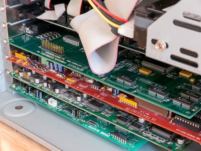

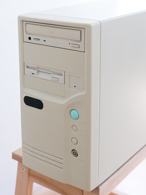

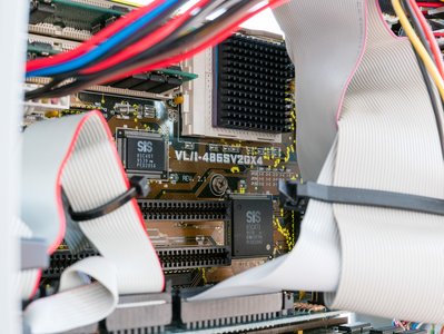

here is my 486 VLB rig - targeted the late 1994. the cdrom type is a little bit newer (from 95), but the 4x drives were available (the cdu55e looks externally identical). for me this config has the biggest theoretical value - i collected it for more for one year, it has more quite rare pieces in excellent condition. the psu is a new at one with pfc.
Mainboard Asus VL/I-486SV2GX4 rev 2.1 SiS 85C471
CPU Intel DX4 100 write back cache
RAM Sharp 72 pin FPM 60ns 8M x2
Video Hercules PowerDynamite 2M VLB Tseng ET4000/W32p
Soundcard Creative Sound Blaster Pro 2.0 CT1600 ISA DSP3.02, YMF262 OPL3
Soundcard Roland RAP-10 ISA
Soundcard Gravis Ultrasound 3.74 1M ISA
I/O DTK PTI-265W VLB controller Winbond W83759AF
FDD Mitsumi
HDD Western Digital Caviar 31000 1000M
ODD Sony CDU-77E 4x CD-ROM IDE
Case Baby AT
PSU FSP SPI-250G
