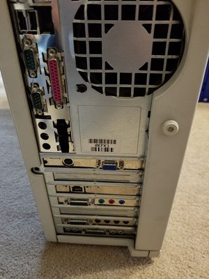

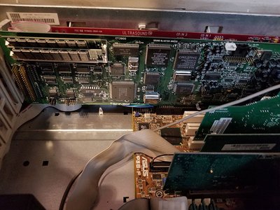

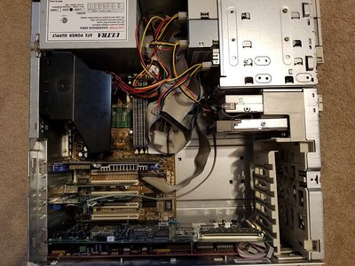

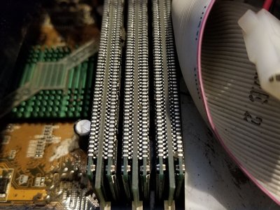

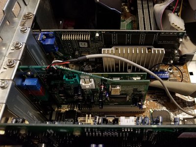

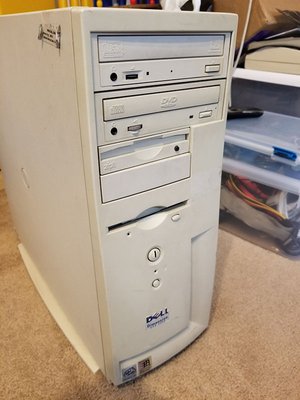

Here is my little baby.
CPU:
Pentium III 500MHz (Katamai).
Mobo:
Asus P3B-F 1.04 (2 ISA slots model)
Memory:
768MB (3x256 Registered ECC ram)
Sound cards:
Gravis Ultrasound rev. 3.74 (ISA non-PnP)
Sound Blaster AWE32 CT3900 with 32MB Ram (ISA non-PnP)
Aureal Vortex 2 8830A2 (PCI)
Video Card:
3dfx Voodoo 3 3000 AGP 16MB
Network card:
3com 3C905CX-TXM PCI

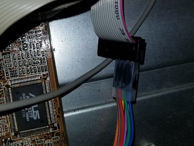

It's a retrofitted Dell Dimension XPS T500
I replaced the original motherboard (Dell oem version of Intel SE440BX-2).
To make it work I had to make a custom front panel adapter. Power supply also had to be replaced.
Three sound cards (cause why not? 😀)
GUS is mostly used for Sfx in dos games
Aureal Vortex 2 is for Windows games that support A3D
AWE32 is used in dos games mostly for midi music and is also installed in windows as a secondary sound device - this allows for loading custom sound fonts for GM emulation in DOS games.

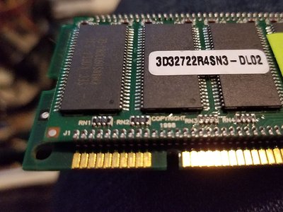

luckybob wrote:
@Vallenrod
NICE! I dont get to see those quad-stacked dimms often.
Yes, I was pleasantly surprised to find out that Asus p3b-f supports registered ecc ram as the manual only mentions unbuffered ecc. I got them on ebay for less than $8 for the whole set so it would not hurt much if they didn't work. My Intel SE440BX-2 (and it's Dell oem version as well) does not recognize them properly all three sport the same chipset so go figure, I guess the Bios is the key.

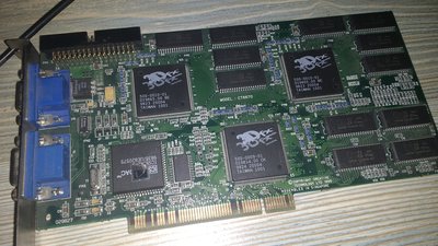

    Creative V2 8mb
