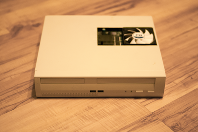

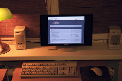

And here is my little YOLO thingie:
1.45 MiB
7497 views

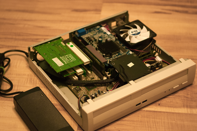

It's a micro-ATX Pentium 3 from my sig inside a slightly modified (for silence and long life) mini-ITX case from the early 2000s.
1.63 MiB
7497 views

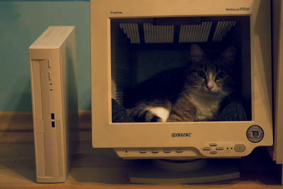

The black duct taped stuff is an IDE/SD adapter held upside down. As its kinda hidden away when its turned on - here is a photo of it getting dwarfed by the 15" cat house (and yes, the CRT was dead and beyond repair):

Amazing PC.. makes my efforts of doing the same with a C3 mITX board ridiculously large and ugly. I love it. What board is this?

Although.... your p3 is DEAD SEXXY. I had no idea they even existed in that form factor!

It is a DFI CS32-TC - but I plan to swap it for a Chaintech 6VIA5T in the near future (to improve the DOS-sound compatibility). Too bad none of the two has the onboard LAN, so it's either a dedicated NIC or a WiFi dongle (the RT2571W ones work great in 98SE/ME and can do WPA2).

How is the PCI video card connected? What kind of sorcery (riser) is this?
Reply 1345 of 2709, by Revolter
This was actually an unexpected turn of events 😀 The video card is a regular AGP GF2 MX, and initially I intended to just use a normal "right-angle" AGP riser for it (so it would occupy the same position the green PCI audio card now uses) and deal with the audio later. But this AGP riser I found really cheap turned out to be a "left-angle" thing I never knew existed - the board even refused to start with the GF2 in its "normal" position (away from CPU and its heatsink facing the mobo).
I thought this was a disaster (because AGP risers are hard to come by these days and are often pricey) and that the build came to a full stop for indeterminable period. But then I decided that a slightly mangled case that works is better than pristine one that doesn't 😀 So I bought a file and took it to the rear of the box - to remove the metal preventing VGA port from being connectable.
The rest of the cards are connected via totally regular PCI risers which are still being made today (just PCB extending the slots): the audio card is on the "2-storey" one, and the NIC is on the "1-storey" riser.

I really loved this one! 🤣

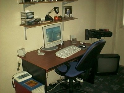

This was my room 15 years ago.
Athlon 1.4GHz, 256Ram, Geforce3, 15" Hitachi lcd (payed an arm and a leg for it at the time) Aureal Vortex 2, Creative 2.1 and a wireless mouse.
And a VCR to record my Babylon5 episodes back in the day.

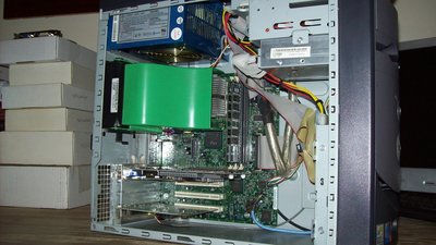

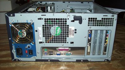

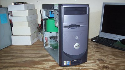

New member here!
After aquiring the parts from mostly ebay, i present to you, my WIN98 retro gaming machine, all wrapped in a Dell Dimension 3000 case...
CPU - Intel 1.0Ghz 133fsb Coppermine
MOBO - Intel D815BN s370 mATX
MEM - Kingston 2X256mb pc133
HARD DRIVE - Quatum Fireball EX 6.4gb
VIDEOCARD - Abit Siluro GF3 64mb AGP4x
SOUNDCARD - HP Creative Sound Blaster AudioPCI 128 ES1373 CT5801
POWER SUPPLY - Enermax 420w EG425P-VE
Dell DVDrom - Dell 3.5'' floppy drive

Hah sweet, what a peculiar build. The parts are all good but try to source a faster, larger HDD. 20GB 7200RPM or larger storage would do wonders.
I love old photos like this. We should have a "retro rig photo thread" that is retro photos of our old rigs.

Well, i do have a seagate 40gb IDE 7200rpm drive handy... i could give that a whirl and see how that goes.

That's a neat build you've got there. I've always liked the idea of reusing old OEM cases for different builds like that.

I did it once before with a dell dimension 4600 case, same design as the 3000 seen here, but inside was an i5-2500k sytem... it was bitter sweet.
