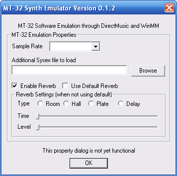

What's the difference between that one that you attached and this -> http://sourceforge.net/projects/munt (mt32emu_win32drv-0.1.3.zip)? The one at the Sourceforge page is a manual installation (unzip and use the included INF file), while the MuntSetup.exe file that you attached I'm sure is an actual installer.
I extracted the files from the NullSoft installer (MuntSetup.exe), and it appears that the MT32EMU.DLL is indeed newer and larger (although the file properties report the same version, only a newer copyright, 2011). Also, the installer includes SDL.DLL (which AFAIK the older version doesn't require).
Anyhow, just a-wondering what the differences are (i.e. are there any bug fixes or feature updates to the newer one)? The older version from Sourceforge (that I currently have installed) has a "settings" menu that could be accessed from the WinDoZe Device Manager, but it was non-functional.
    5.86 KiB
    9184 views
    Device Manager/Sound, Video and Game Controllers/MT-32 Synth Emulator/Properties/Settings

Reply 6 of 10, by collector
rfnagel wrote:
Just curious: […]
collector wrote:
Try this
Just curious:
The driver itself is recently taken directly from SourceForge.
If you had read the thread in the MT-32 Development forum you would see what the reason for it is. The inf does not install on 64-bit systems. The driver can be manually installed, but involves steps that some would not be comfortable doing, such as manually registering the DLL and making a registry entry. The later cannot be done with just a .REG file as the registry need to be checked first so as to not overwrite an existing value. There is also the System32/SysWOW64 and the registry Wow6432Node redirects to be taken into account.
Even though the script was made with the intent to make it possible to install the driver on 64-bit systems, it will work on 32-bit Windows as well.
